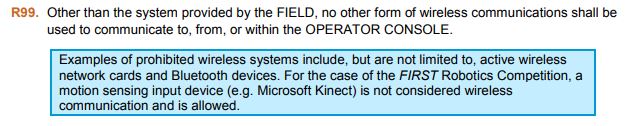

There is no rule specifying a finite list of legal gamepad controllers, or controllers in general. Any controller you do use must satisfy R99.
R99
Additionally, I highly suggest you reread all of the rules. Not meaning any offense, but if you skipped over or forgot the rules in §10.10 (Operator Console) then there are probably some other rules you missed too. Better to catch that now than at competition. Good luck with the rest of your season!

The only rule with controllers is that they can’t be wireless, and also that the connecting wires aren’t 10+ feet. They don’t want people on the far right driver station wandering all the way over to the far left side.
