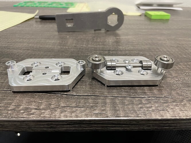

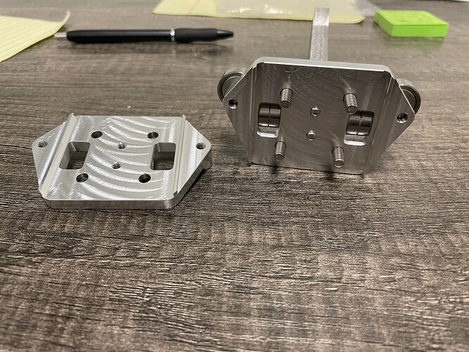

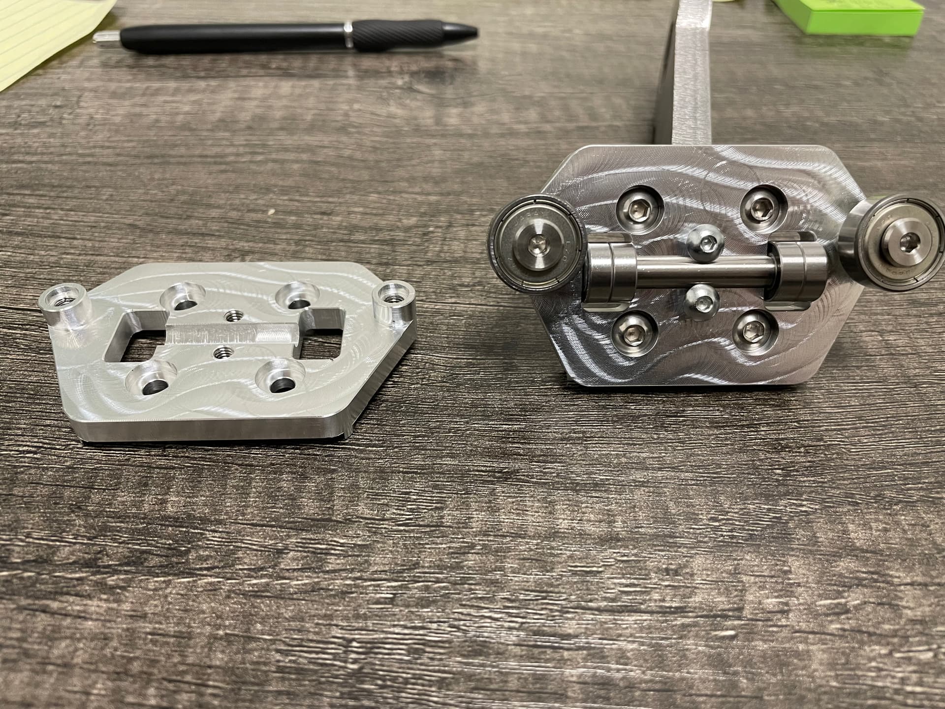

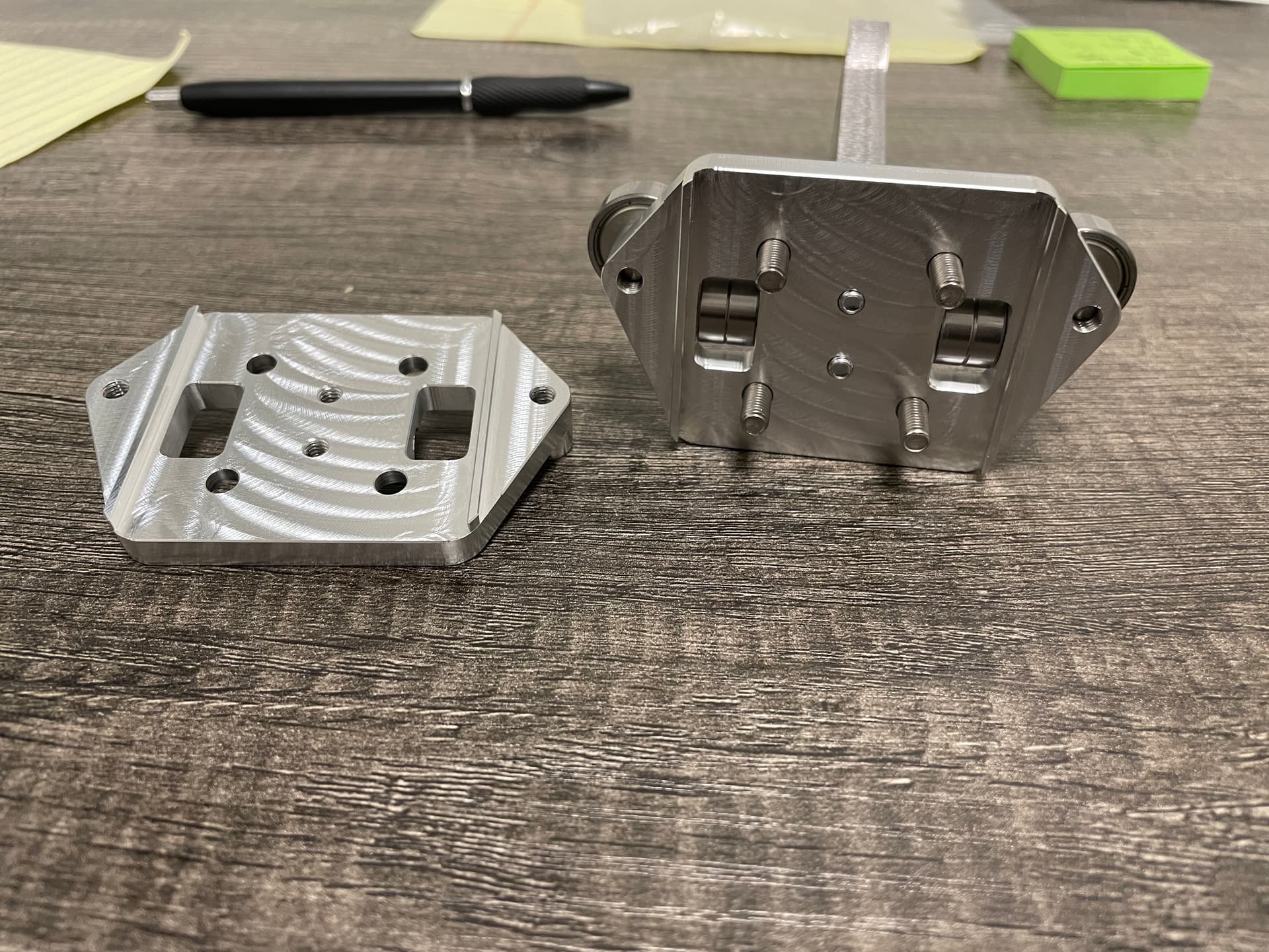

As far as the ownership of the mill, we will treat it as if I own the mill. The parts are functionally the same as the elevator blocks currently on the market, just with some quality of life improvements. Here is the grabcad link to the blocks in question
-uses 1/4 ID x 3/4 OD bearings for outside edges
-uses doubled up 1/4 ID x 1/2 OD bearings on inside face
-No spacers required. Everything is machined as one piece
-has counterbore to support shoulder screw and take load off the thin section of the shoulder screw where the threads begin
-lines up with WCP tube plugs and existing pre-drilled tubing
-uses 8-32 screws to retain cross pin holding the 1/2” OD bearings
Can you post a screenshot/irl photo?

Idk…they do resemble thrifty’s but you are pushing it lol…

And, I argue that these are not functionally equivalent at first glance. They have adjustments. The two biggest (for determining equivalence) are as quoted:
I’ll buy the shoulder screw counterbore being a 30-minute modification with a hand drill–that’s something I can do fairly easily, and more to the point I can train a student to do it that fast with a drill bit. (Or a commonly-available counterbore bit.) Until further notice, I’d have a much harder time with the “one piece” vs “spacers required” setups–depending on the way it’s eventually determined, I could argue that it’s dissimilar in both form and function. I could argue it’s similar. That one is the dicey one for “functionally equivalent”. I’m going to withhold judgement until I see the rules for 2023.
