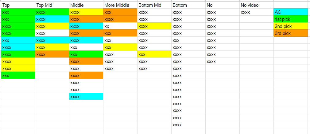

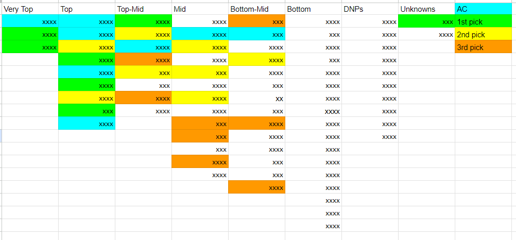

You are correct that one downside from prescouting is teams will change, so the information collected may be a little stale. That being said, teams performances are stable enough that there is still significant value in pre-scouting.
Here are my pre-scouting tiers from the past two championships with where the teams ended up in alliance selection highlighted.
2022:
2023:
Sure, there are some misses in there but in general you’re going to have a very good idea of who the top contenders are and the general depth of the event (which is an underrated aspect of alliance selection and strategy). Teams don’t change that much.
I don’t think my team will do this, but if you’re a smaller team, I think it would be valid to scout the teams in the Bottom or DNP tiers less, if at all, as they are unlikely to make it to playoffs.
