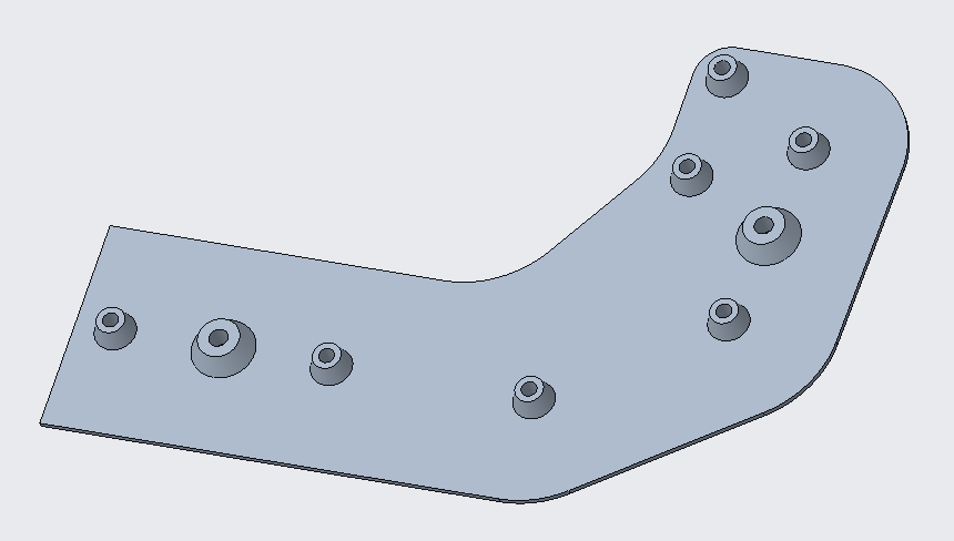

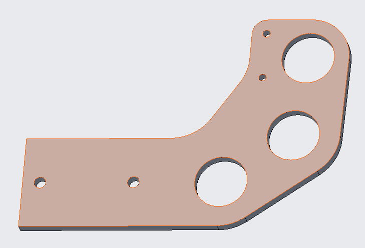

2363 doesn’t have a CNC router, and we lost our laser cutter. We now use our 3D printer to help make flat parts quickly. Let’s say we have a part like this that we want to make from lexan.

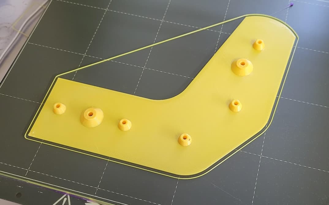

Laying the part out by hand is labor intensive and error prone. Instead, we can 3D print a template like this.
We cut a couple pieces of scrap to the rough size of the template, layer the template and the 2 pieces together in a stack using screws through the two larger nubs, which are sized for a #10-32 tap drill. Then locate the other holes by match drilling through the stack with a 1/8" drill. Then bandsaw, belt sand and file the parts to the perimeter of the template. Finally, separate the parts and open up the located holes to their final sizes on the drill press. WIth the template in hand, we can knock out a couple parts like this in 30 minutes or so. Not quite the rapid turnaround like when we had our laser cutter, but way faster than hand layout. And more accurate than using a paper template.
Here’s an example template.

This is awesome. There is so much teams can do with a couple good tools and creativity. Its an improved version of printing a template on paper.
Really like how you guys raised the area around the screws – definitely helps ensure that holes go in flush.

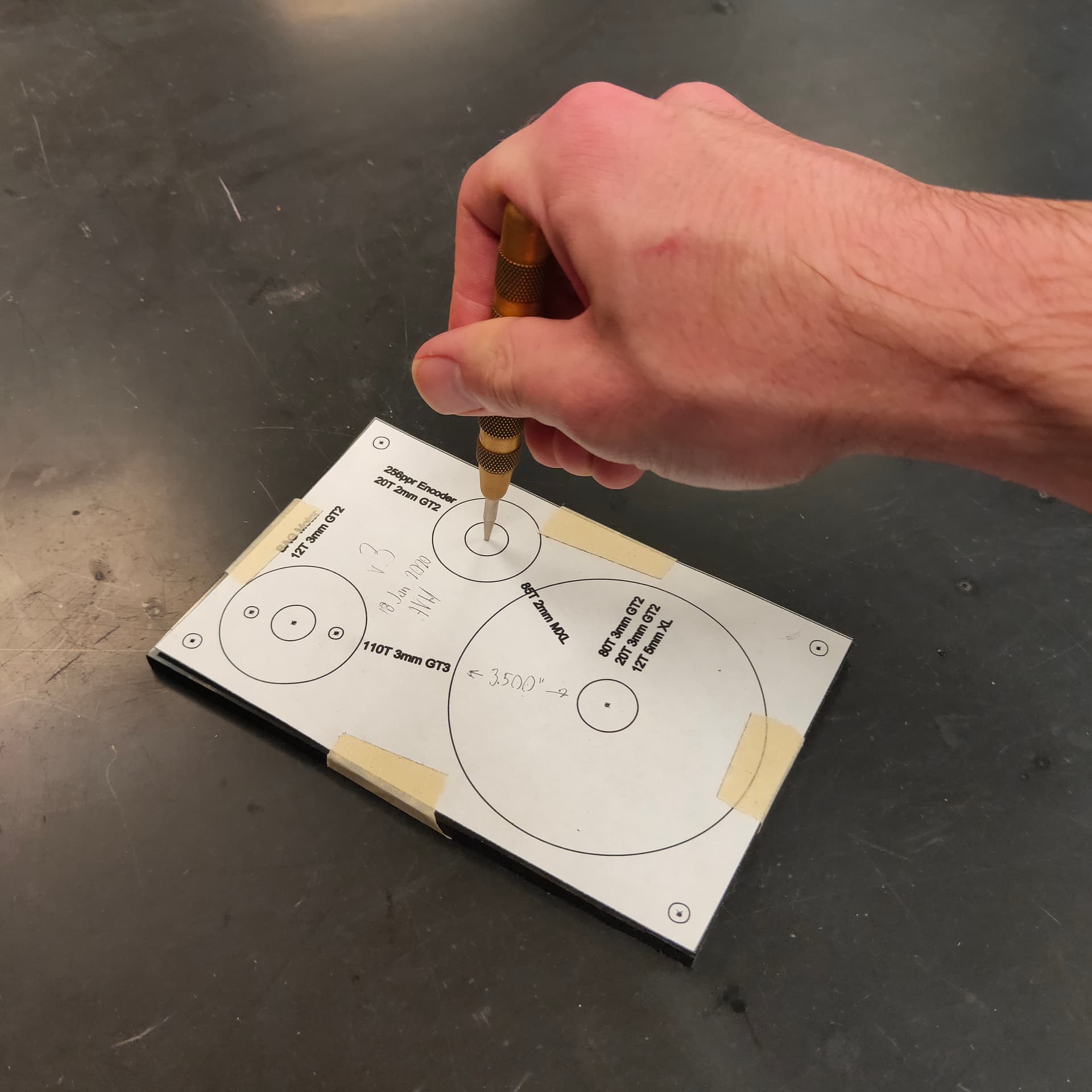

we’ve made our parts with actual 1:1 paper cutouts for years. Not as cool as 3d printed, but much quicker.

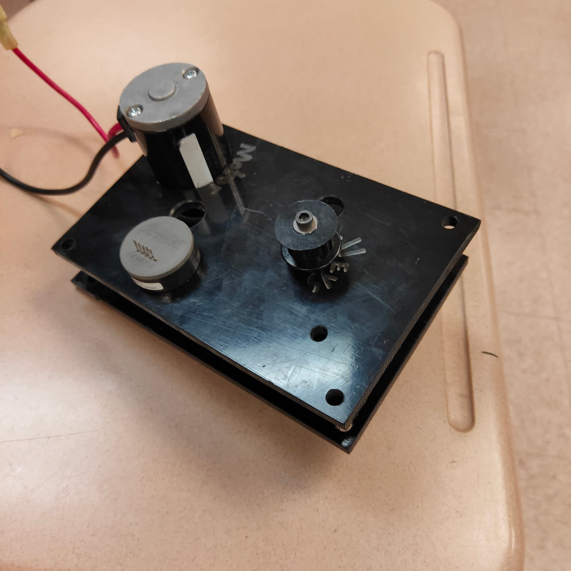

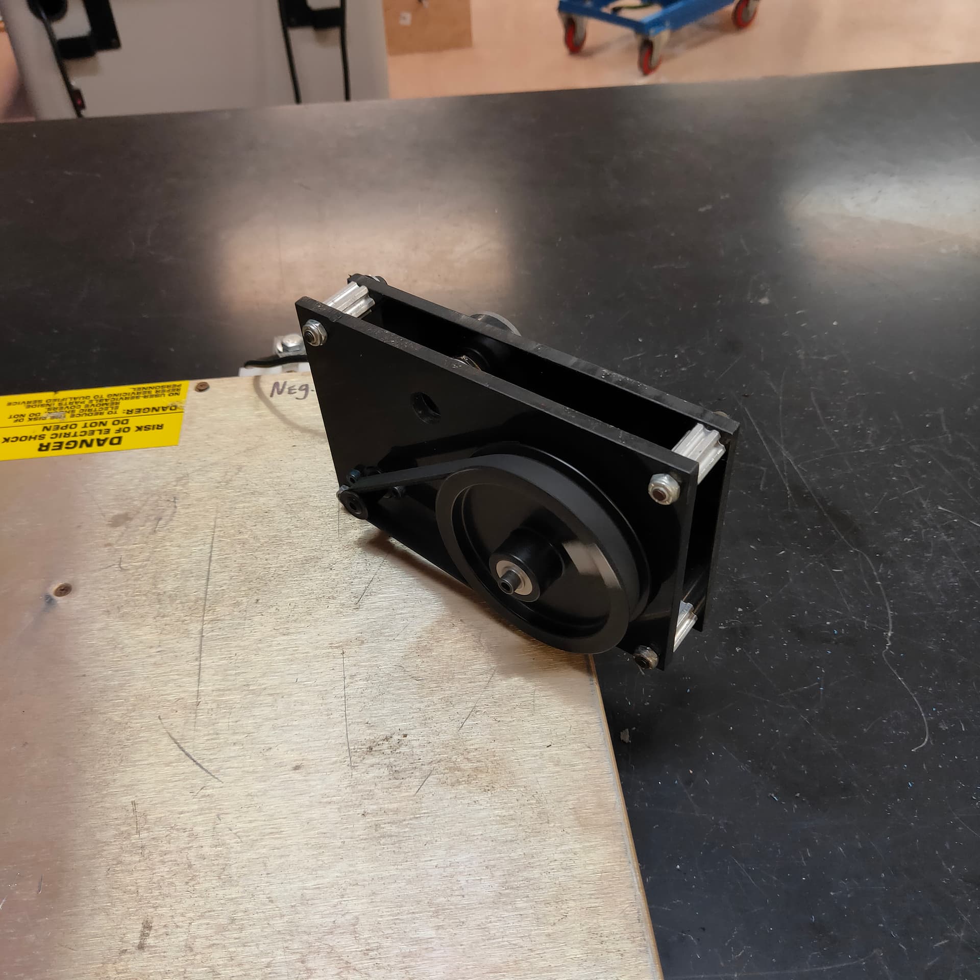

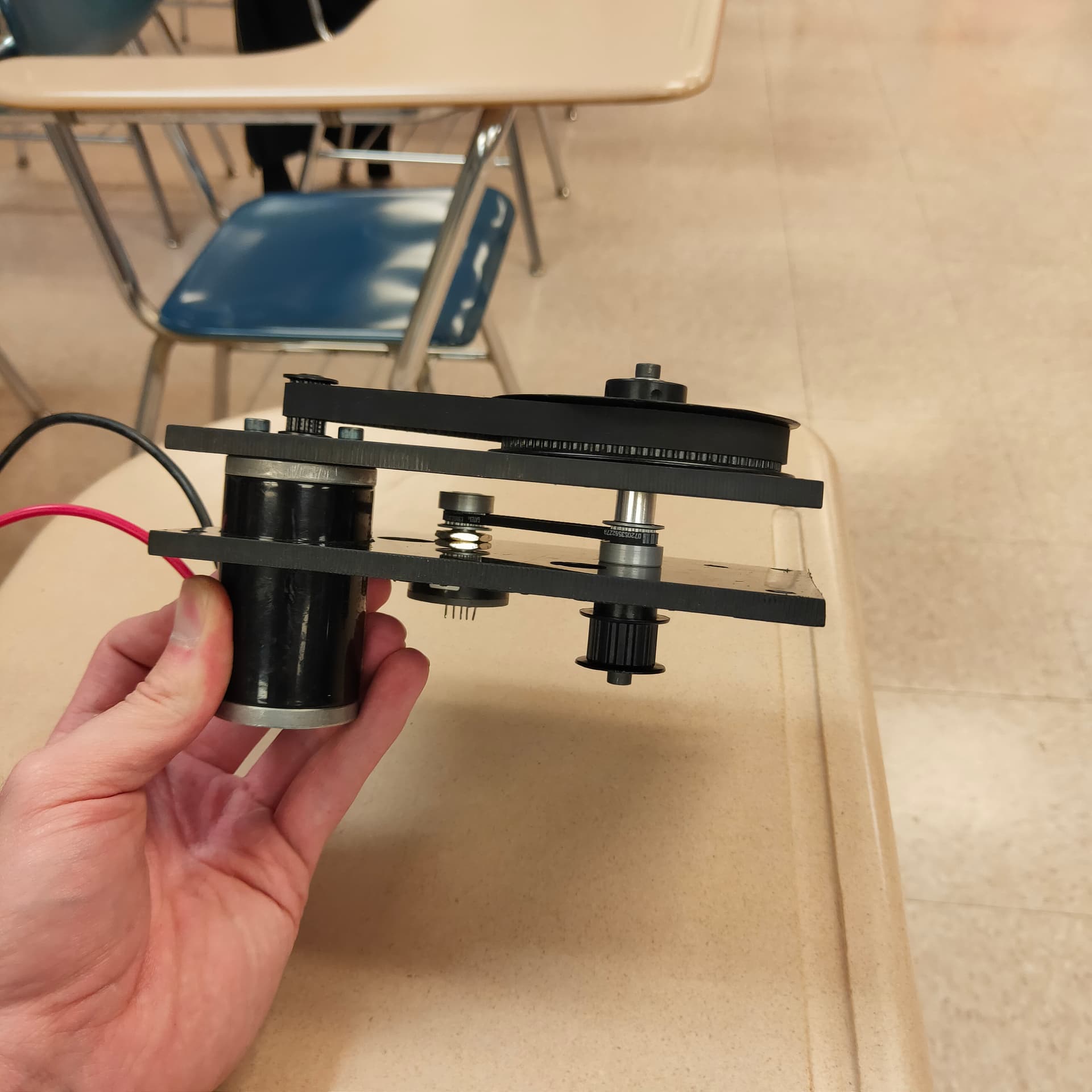

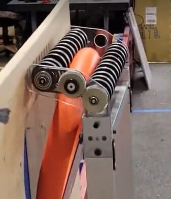

It takes more skill and care, but you can get great results with paper. Here’s a prototype belt reduction drive from 2020 where the plates were entirely hand-fabricated in HDPE this way. Tools used were a laser printer, a center punch, a cordless drill (with step bits for the larger holes), and a bandsaw. (A custom shaft and standoffs were made on a manual lathe.) It worked great; the robot got an exact copy machined in aluminum.
Video of it being tested.
