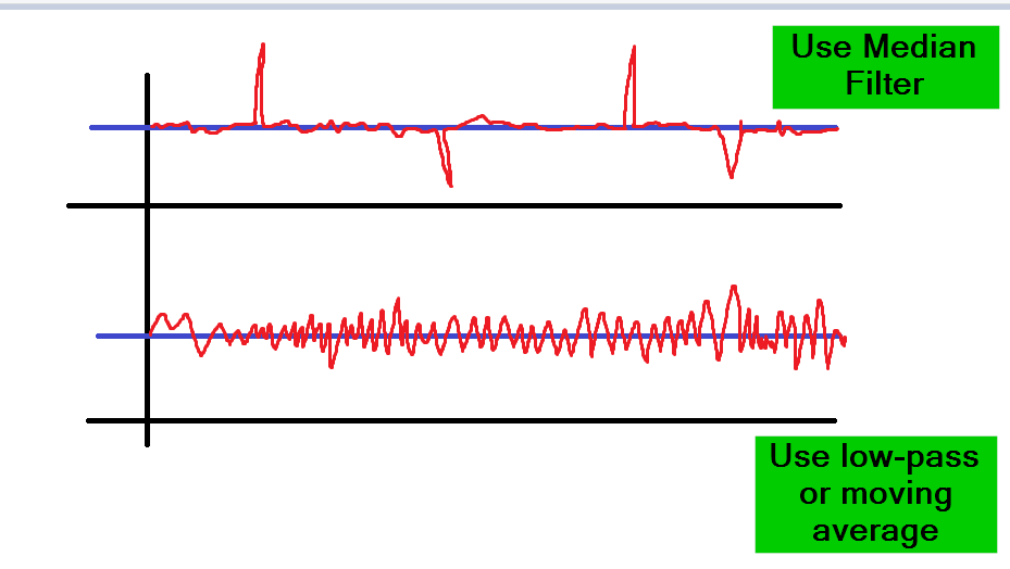

Consider using a median filter or throwing away measurements that are too far from a moving average of the measurements.
In pictures: shot-noise vs. gausian distributed:

Median filter settled it right down. Works good beyond 15 inches, gets less accurate below that but still usable.
