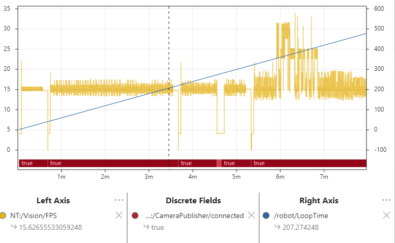

As with many others I have been playing with AprilTags, and I think I came to a roadblock that should be looked at. I think the CameraServer.CsSink.grabFrame() function has an issue, and I think it’s affecting anything using CameraServer (both WpiLib and PhotonVision).
I was suspicious because while we are limited to ~7FPS with AprilTags reading, we were also only using ~40% CPU and why we can’t make data processing more parallel.
So, I made a VERY simple vision loop (posted below) in Python; just grabbed a frame and did nothing. Then I took the time between loops and logged it. This is a plot of the FPS, notice it groups really bad at 30, 15, and 7.5 FPS.

I’m definitely not CPU bound, running the WpiLibPi v2022.1.1 image on a Pi 4b, 2GB of RAM, LifeCam HD-3000 camera, configured in WpiLibPi as a 640x480, 30 FPS cam. No other streams were running on the Pi (verified by the Network traffic from Pi). Data collected on my laptop using the Robot Simulation (only to run a NetworkTables server and using WpiLib logging, used AdvantageScope to plot the data)

I had a PiCam laying around, so I plugged it in the CSI slot, configured WpiLib with only that camera, and ran the same dummy code for ~5 min, so it looks to be an issue with the UsbCamera instead.

So, for the first minute, I didn’t set a size/FPS in WpiLib, so I changed that. Then from 1-3, it ran 640x480px30fps, but I only got 15. I tried a hot replug between 4-5, then at 5:30, I bumped it to 1280x720px30 (one of the supported modes). It stayed pretty idle, but at 6 min, I moved the camera, started flashing AprilTags, and watched the frame rate change when I showed a full screen tag vs my lit hallway (no decoder is running).
I wonder if this camera is limited CPU and can’t push the frames.

So, after a little more playing, it does seem to be the camera realizing it can’t process the frame and just drops it. I can move the camera fast and watch the frame rate drop quickly. Sometimes it recovers, sometimes it doesn’t. I tried shutting off all the auto calibration things, but still can’t get a stable 30fps off of it while moving (in hand). I will say, auto-exposure killed the camera, the frame rate just drops to zero.

First, the fps is sensitive to exposure. I get 30 fps with low exposures resulting in very dark images from “black” to barely discernable blobs.
FPS drops to 15 then 7 as exposure is brightened. (Same break points as you see.)
Auto exposure consumes an inordinate amount of time and is repeated frequently so I agree that it is useless in this experiment as the camera apparently can’t take pictures and adjust exposure at the same time nor quickly.
