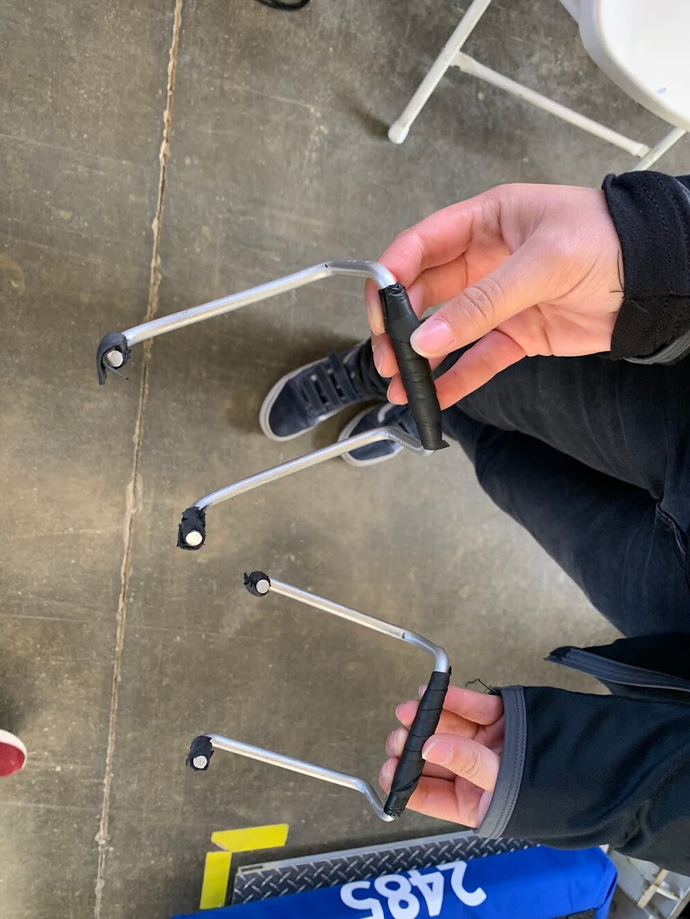

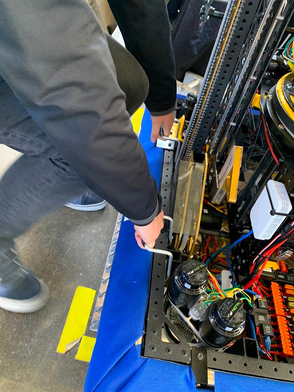

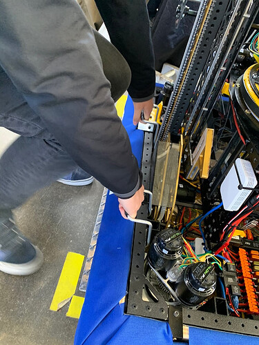

Handles also help. Here’s Team 2485 W.A.R. Lords at SDR.

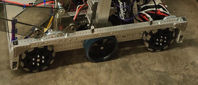

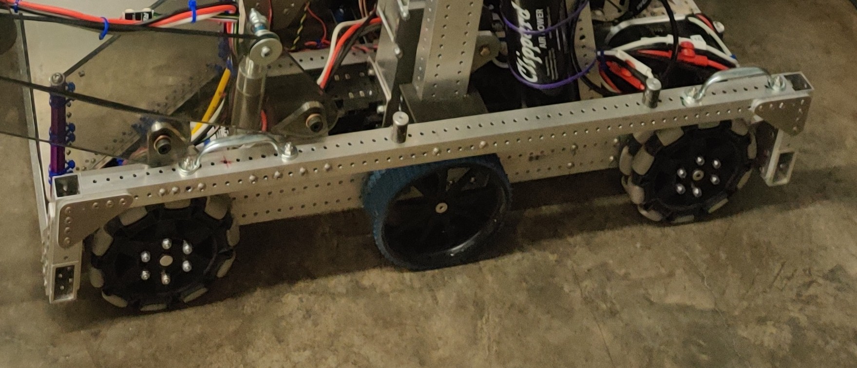

We found these nifty cabinet handles that just so happen to fit a standard .5" hole pattern. Really handy for lifting the robot off L4!
