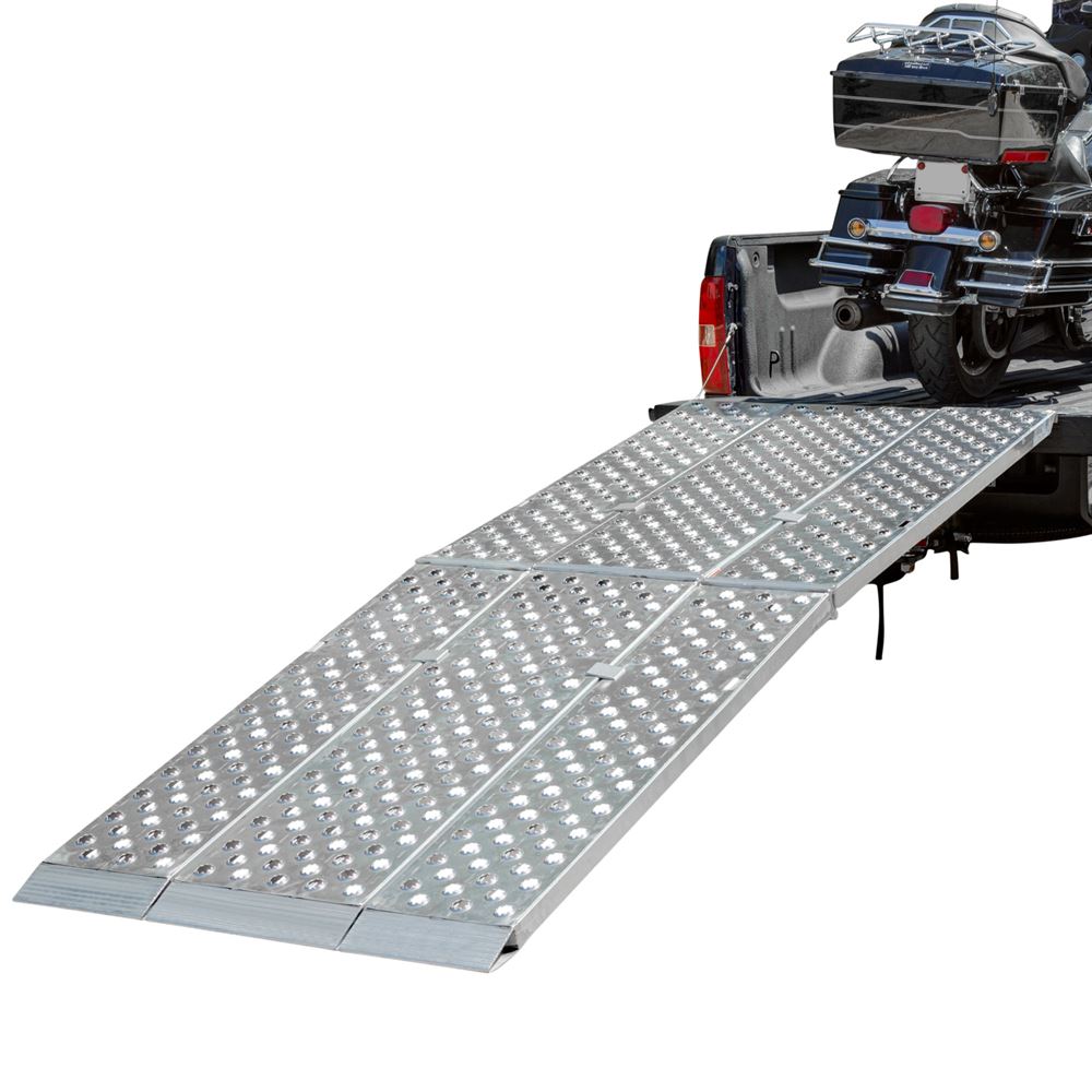

What is a good way to construct a ramp light and strong enough to hold a robot? 1678 had one that was obviously strong enough to withstand competition and I heard (can’t remember where) that it weighed somewhere on the order of 10 lbs. How would you design a ramp to have this kind of strength with this low mass?
Go shopping for motorcycle ramps, for inspiration?
