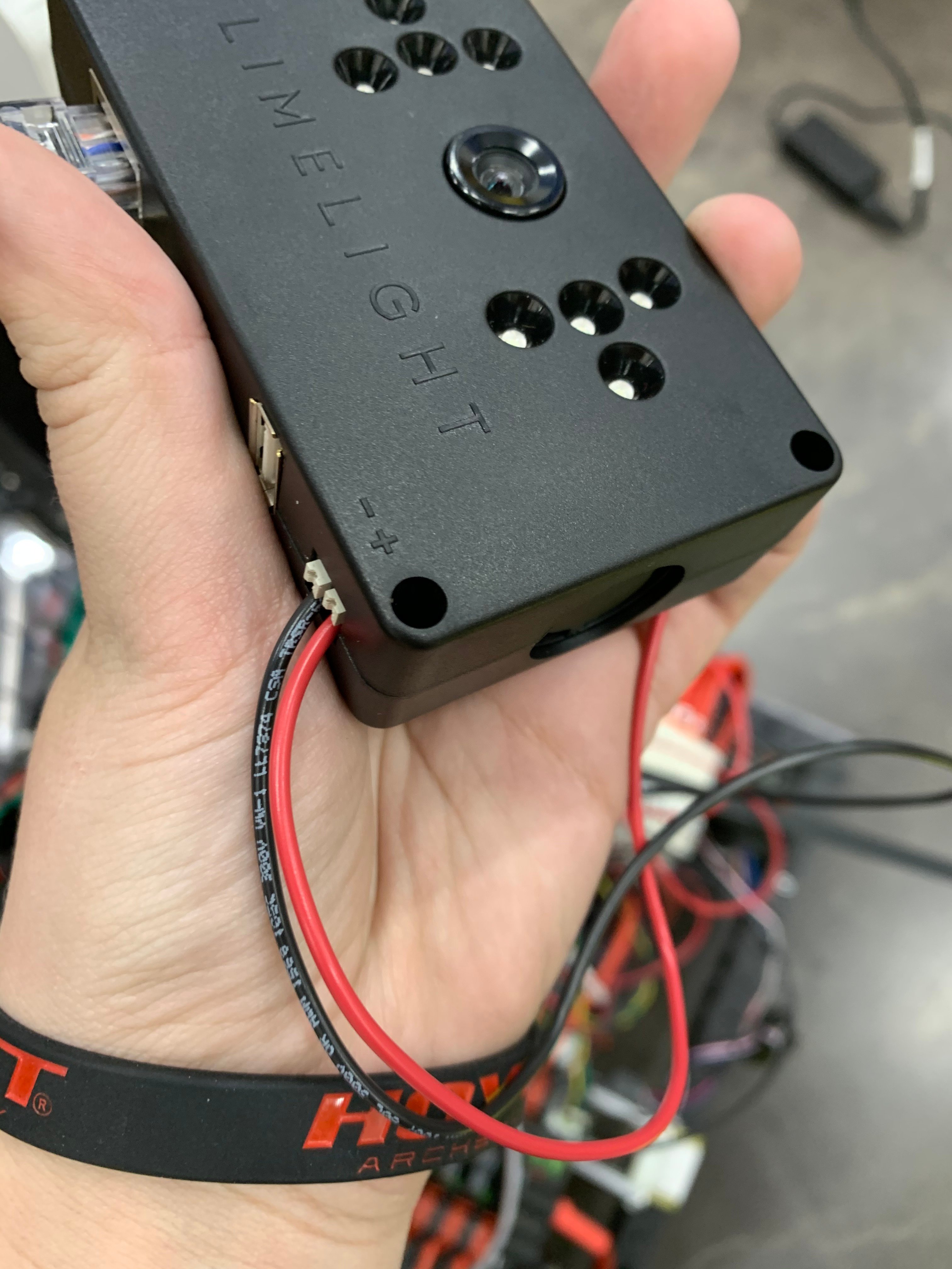

Hi! We’re unable to get power to our Limelight 2s. We’ve connected it to the PDP and rechecked the wires a bunch of times. It’s flashed and up to the newest version as well.

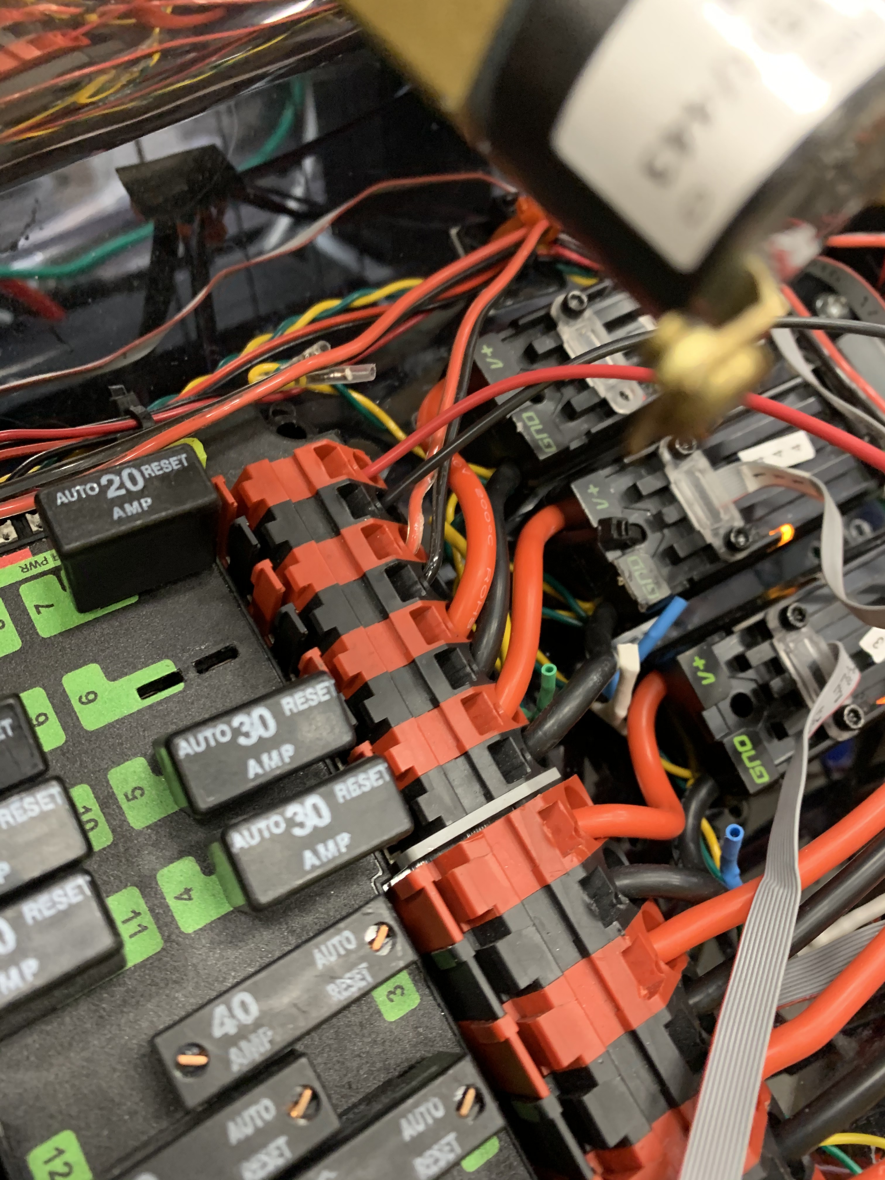

Send a picture of your wiring.

Wiring, not writing, as in the wires on your testbed/robot.
So, port 6 is missing a breaker, what port is the limelight plugged into on the PDP?
Also, it is possible that you have not stripped your wires long enough for them to make electrical contact.
I would try first probing the ports of the PDP with a multi-meter then try tracing that to the limelight. If you are getting power at the leads that are plugging into the limelight then it’s either an internal limelight problem or the connectors on the limelight aren’t making good contact.
Unplug the wires from the PDP and verify that the PDP is clamping on the wires and not the plastic.
