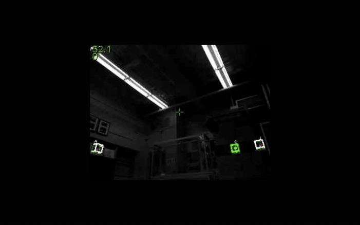

  • All networktables botpose arrays (botpose, botpose_wpiblue, and botpose_wpired) now include Tag Count, Tag Span (meters), Average Distance (meters), and Average Area (percentage of image)
  • These metrics are computed with tags that are included in the uploaded field map. Custom and/or mobile AprilTags will not affect these metrics.
  • With device calibration and this botpose array upgrade, we do not believe JSON is necessary for the vast majority of use-cases this year.
  • The JSON dump now includes botpose_avgarea, botpose_avgdist, botpose_span, and botpose_tagcount for convenience.
[tx,ty,tz,r,p,y,latency,tagcount,tagspan,avgdist,avgarea]
