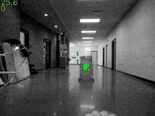

My team has gotten a limelight 3 and are trying to use it to get its position on the field using April Tags. We want to be able to consistently get the robot’s position from behind the charging station. I’ve tried tuning it to fix this problem, but haven’t been able to get it to work that well. Here is the problem I’m experiencing:
chrome-capture-2023-0-28
How do you suggest I tune it to maximize accuracy and fps at this distance? Also, what fps do you think we should be aiming for in general?

Can you share a snapshot of ur video output?
chrome-capture-2023-0-28 (1)
I would start by increasing the capture resolution on your LL to 960p.
Your Limelight should be mounted above or below tag height and angled up/down. Your target should look as trapezoidal as possible from your camera’s perspective. You don’t want your camera to be perfectly completely “head-on” with a tag if you want to avoid tag flipping at long range.
