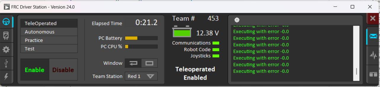

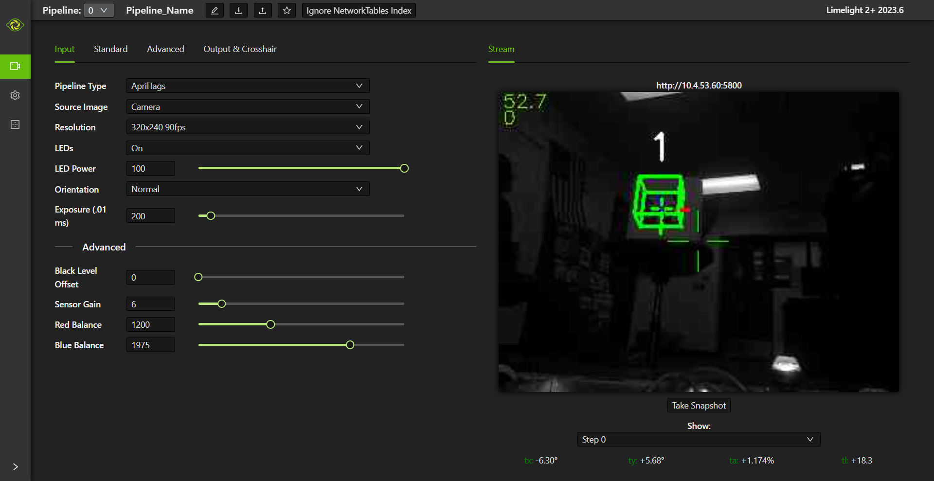

Hey everyone,
I’m running into an issue setting up a Limelight vision system where it’s always returning the default value, and I’m not sure what’s causing it. I’ve attached some screenshots to give you a clearer picture of what’s going on.
The goal is to align the bot with an apriltag when the 9 button is held down. Here is the code.
