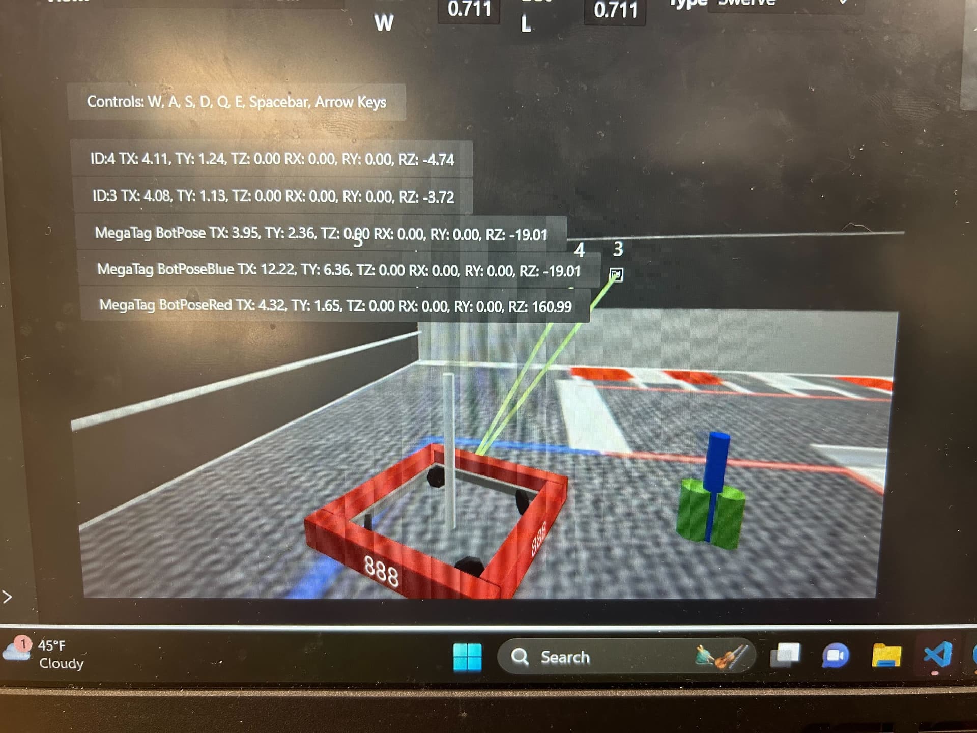

I was working with limelight trying to get the MegaTag botpose with April Tags.
When only one tag is in view, the botpose is unstable, but it is acceptably accurate. (can’t embed an image because I’m a new user, but here is a link to the image: IMG_2764.jpg - Google Drive)
When two tags are in view (like in front of the speaker), the botpose becomes completely wrong, especially in the side-to-side directions:
The pictures are taken with the bot in the exact same position (we just covered up tag 3).
Any idea as to what would be causing this?
[Edit] It should be straight ahead from between tag 4 and 3

The issue was solved by making sure that all tags were in the correct place. Issue was caused because the tags were a few inches off of where they actually should have been (relative to each other)… we didn’t take into account the whitespace when calculating April Tag positions.
