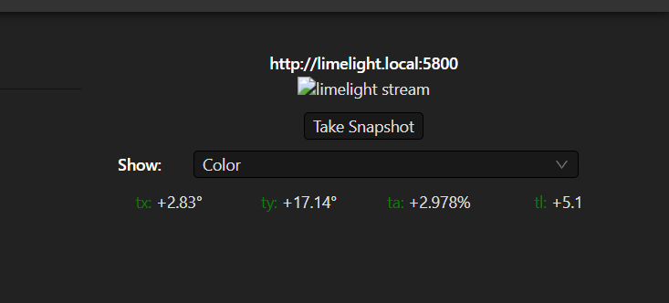

We are currently configuring our limelight vision camera. However, the livestream from the camera is not showing up. Does anyone know why this is the case?
That’s odd! That looks more like a web browser issue rather than a limelight issue. Have you tried switching browsers?
Typically, I get this when my browser caches the :5801 page, but I’m no longer connected to the limelight. Have you tried refreshing the page without cache (CTRL+SHIFT+R for most browsers)?
I had the same issues above.
Fix:
  1. Make sure you are using chrome, or firefox. I have had issues loading the limelight config in IE, and edge.
  2. As @Loading_M stated, refresh without cache ‘CTRL+SHIFT+R’
  3. Try connecting to :5800 for a direct livestream. Sometimes that will wake it up.
We’ve tried using many different browsers (Chrome, Firefox, Internet Edge and Explorer. etc.), have cleared the cache, and tried reloading the page without cache, yet we still haven’t had any success.
We haven’t seen this before! Please contact us on our support page if you’re still having trouble.
