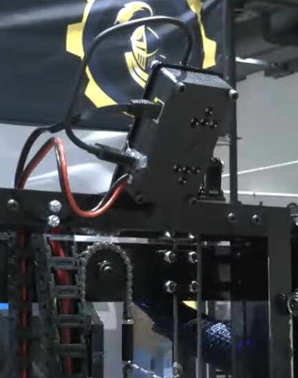

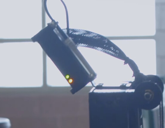

Here is the best pics I have of the coral+limelight, the coral is behind the limelight
IMG_2589
