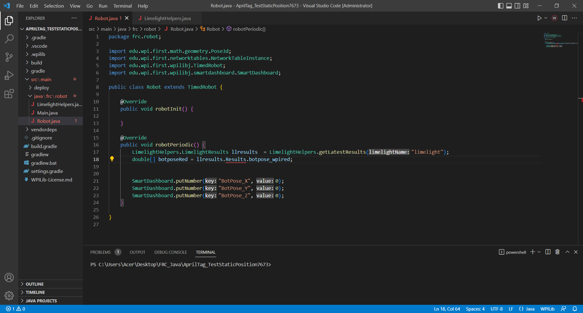

I’m try to print the robot pose on shuffleboard, but there are something wrong on my code.
Can anyone help me to slove this problem?

Try this? (not tested)
LimelightHelpers.Results result = LimelightHelpers.getLatestResults(“limelight”).targetingResults;
if (DriverStation.getAlliance() == Alliance.Blue) {
Pose3d botPose = result.getBotPose3d_wpiBlue();
} else {
Pose3d botPose = result.getBotPose3d_wpiRed();
SmartDashboard.putNumber(“BotPose_X”, pose.getX());
SmartDashboard.putNumber(“BotPose_Y”, pose.getY());
SmartDashboard.putNumber(“BotPose_Z”, pose.getZ());
I will try it. But, what is the differential between
“getBotPose_wpiBlue()” and
“getBotPose3d_wpiBlue()”?

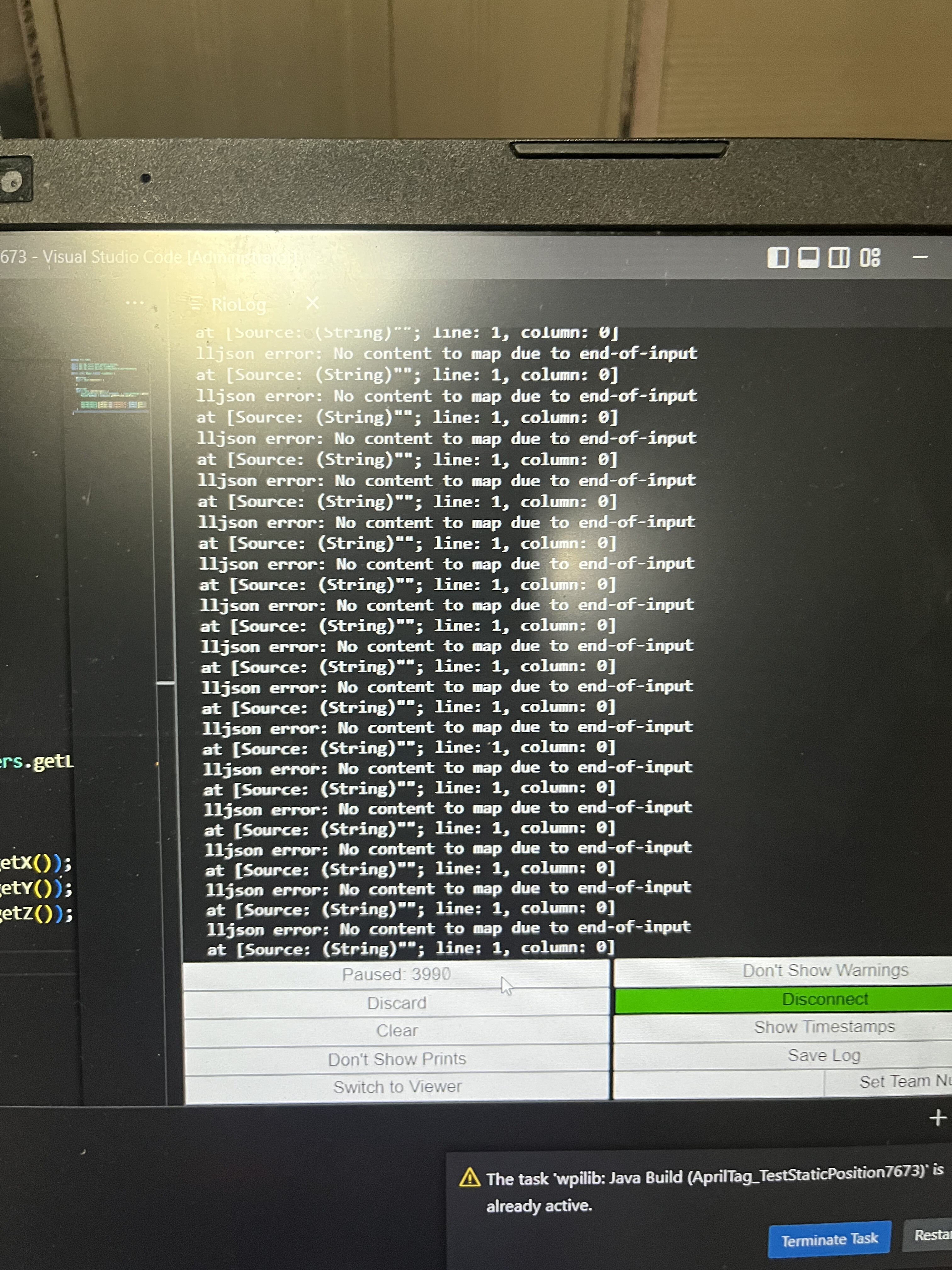

I can’t update the data to dashboard. Do I ignore something?
I meet the same problem, even if I read other CD posts and GitHub.
Can anyone help, please?

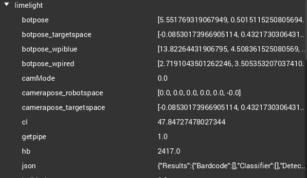

That error is saying that the json file from the limelight is empty.
This hapenned to me because the limelight was not configured properly so it was not showing up in the network tables. Another time it was not plugged in.
Make sure you can open the Shufflboard and see the block of network variables from the limelight.
