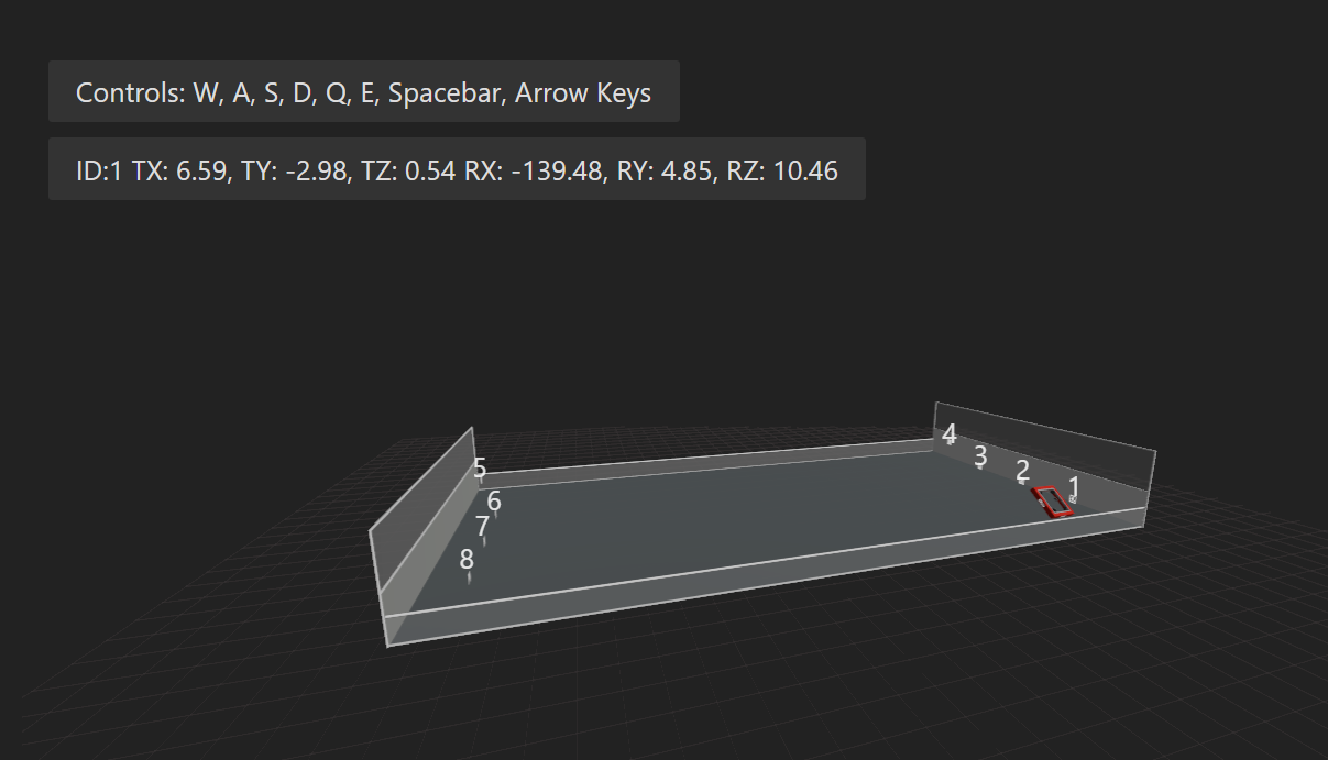

Do you have Full 3D tracking turned on? Does the Limelight show a 3D pose in the UI?
yes, exactly. thus i felt weird about that.
this is what it showed on the panel.
alright, it turns out to be some problems with an empty pointer, now we changed to parsing JSON and checking empty pointers in advance then it works well.
