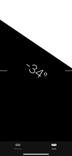

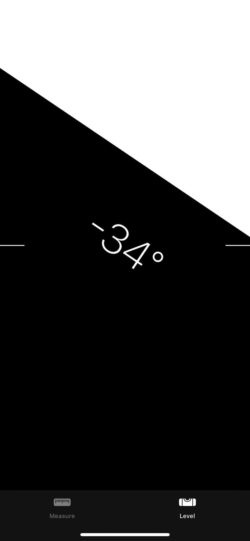

If you use iOS, the built-in “Measure” app has a level function that can tell angle of elevation. Super helpful for this.
I use photonvision, and I’ve found photonvision’s distance to target method to be more reliable than the measure app.
I wasn’t talking about getting the distance to target, I’m talking about getting camera pitch. The Level function looks like this. I put it up against my camera and it tells me angle away from the horizontal. Recently our camera mount was bent in a match, so I used this to check if the pit crew got it back to the right degree.
oh that’s cool. our camera was on a fixed mount installed onto the robot frame so it wouldn’t budge. We just adjusted our shooter hood using a pneumatic piston so the 2 positions don’t mess up. Ours was a simple and robust design. We did have to do a little bit of trig to find our best shooting distance from each angle though.
