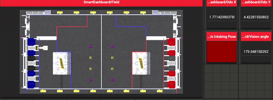

Hi, we’ve recentrly replaced our Apriltag tracking camera using Photonvision for a Limelight 3, we’ve managed to add the vision measurements to the pose estimator with no problems but the thing is that when the camera stops detecting tags, instead of using the last know position and encoder readings, it returns the robot the odometry origin (bottom left corner) and it cant get out of it even with the motor encoder readings.
Pose estimator behaviour
Am im missing something?

I would check the bot poses you are adding. We filter out “zero bot poses”.
We get the TV value from the limelight and only add vision measurements if that limelight is currently seeing a target (TV = 1)
I did see this on another thread: Introducing Limelight Lib - #59 by jdaming
Basically, the limelight helper function was returning result.valid as true even when no target was in view. I’d recommend just using the network tables API they provide.

The TV value instead of the results.valid fixed my problem, but still there’s other cool suggestions that i could implement.
