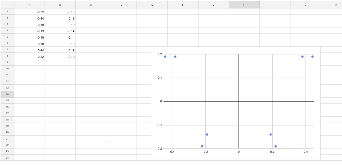

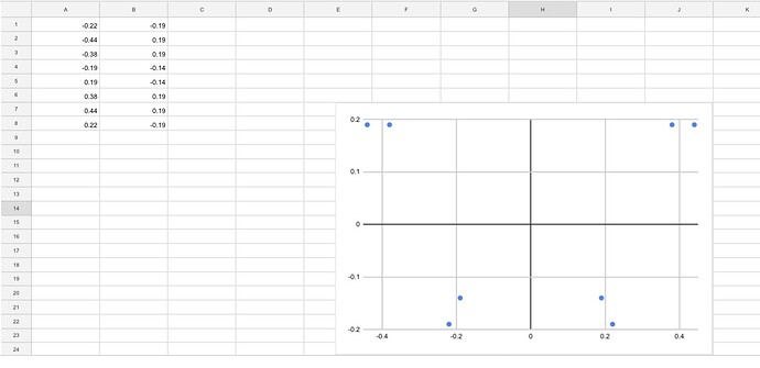

Hey everyone, we have had some trouble with the new 3D features of our limelight 2. We have successfully got the thresholding working and managed to filter out everything except our target and now we are trying to get the robot to detect the shape of the target. There are no 2020 targets on the limelight website so we made our own (pictured below) For some reason, the limelight will not detect the shape of the target and generate the vectors as shown in the patch notes here. We have checked the units of the spreadsheet and our image is pretty well processed(we have filtered out all the other lights from the image and we have minimal flickering with a relatively sharp image). Has anyone else had a problem like this and if you have how did you solve it? We are going to try processing the image a bit better and I’ll leave an update if it works.
Edit: I just saw that the 2020 PnP images are coming out tonight. We will also try using those instead of our homemade ones to see if it works
They were in stock effective at noon today, but were out of stock by 6pm (likely earlier). Last I checked, they’re still in stock on the limelight website though.
Update to the above post, we have tried using the new pnp images and we still have had no success with the compute 3D function of the limelight. We have very good thresholding but the 3D function still will not detect the shape and give us any information on our position to the target. Does anyone have a fix for this?

From our experience, the 3D feature is not reliable at distances greater than 7 feet or so. It requires the edges to be crystal clear.
I also don’t believe you are using the target model for this year’s game, you can download the 2020 Hex Goal model from their website and upload it to your pipeline.
You’ve run into a corner correspondence issue that we are going to address in the next update. In general, we are attempting really improve solvepnp stability at long distances and during movement with some of our own new solutions before removing the “experimental” tag.
