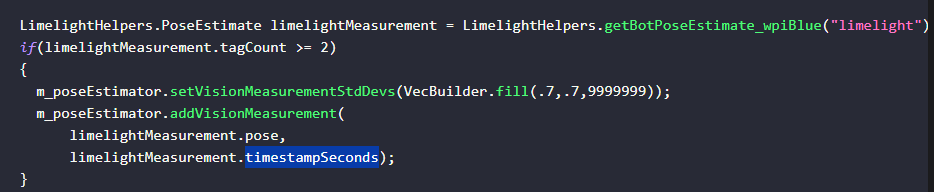

LimelightLib timestampSeconds and CTRE Swerve
The latest version of LimelightLib includes a new PoseEstimate.timestampSeconds and the latest documentation from Limelight sends that into WPI’s pose estimator.

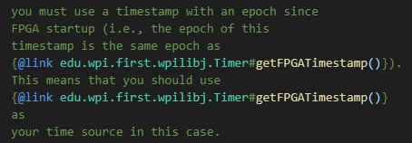

The documentation from the CTRE Swerve says you must use a timestamp with an epoch since the FPGA startup.
And the current example just sends in Timer.getFPGATimestamp().
Based on what I can see on how LimelightLib’s timestampSeconds works, it uses NetworkTableEntry.getLastChange() and adds latency. I think this is also based on Epoch time and therefore would be safe to pass to the CTRE vision logic.
Is my thinking correct?

Yes, NT timestamps are the same epoch as FPGA time, so this is safe to do.

I am aware of the challenges with updating odometry based on vision. I was just interested in the seeming easy way of including latency in the calculation.
This is the code I am referring to from CTRE. It is used in the Robot Periodic and integrates with the CTRE daq thread.Phoenix6-Examples/java/SwerveWithPathPlanner/src/main/java/frc/robot/Robot.java at 536bfad58a4c94f0e3b766aff71d763322b35a0b · CrossTheRoadElec/Phoenix6-Examples · GitHub
Yes prior to the new LimelightLib changes teams were supposed to use (from the LL site) Timer.getFPGATimestamp() - (tl/1000.0) - (cl/1000.0) now it is done for you in the Helper
