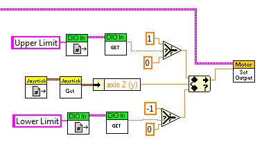

Thanks for your responses. Our team is now actually running a FP motor off the x-axis of a second joystick and needs a limit switch so we donāt swallow our lead screw (the cylinder got used elsewhere.)
Weāre going to mess with this now, but I think the and statement is going to be the answer. The trick will be to have the limit switch stop travel in one direction but still make the reverse (retracting) motion of the motor available in order to unswitch the limit switch lever.
For making the limit switch stop the motor only one way you want the in range and coerce function found in the comparison pallet. This will allow you to set the upper limit or lower limit to zero when the limit switch is pressed depending on what way you donāt want the motor to spin (upper is positive and lower is negative direction)
After considerable thrashing at the in range and coerce icon Iām unable to set the limits. I see the (apparent) array in the NI example but donāt see how to set the constants.
And does this function occur within a true / false case structure controlled by the limit switch DI?
Iām giving up for the duration of the superbowlā¦
Thanks for any leads, or example code or links to same.
One way to do it is to use Select nodes to change the limit for the In Range and Coerce between 1 or -1 and 0 if the switch is pressed.
EDIT: You should make sure to right click on the In Range and Coerce function and check that both āInclude Upper Limitā and āInclude Lower Limitā are checked.
I think your DIO checks are reversedā¦
The DIOās are True by default and False when a switch is pressed.
Whoops! Right you are. Iāll fix up the image right now.
EDIT: Image should be fixed now.
Well, it would have worked the other way as long as the limit switches were wired to be Normally-Closed.
But it looks good now for Normally-Opened, like most people tend to automatically think of a switch.

If you are only limiting in one direction, you can just wire a constant -1 to the side you arenāt limiting of the āIn Range and Coerceā VI. No need to check the switch or use the select statement.
Hah, thatās classic. Weāre just about to get the second limit switch hooked up and were starting to figure how to get both in one section of code. You solved that problem of course at the same time you pointed out my extra work on the last one. I should have noticed the two different switches in your exampleā¦
