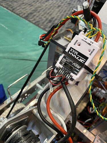

How do you wire the limit switch directly into the controllers? we have SparkMax’s.
Not much benefit to reviving a year-old thread as opposed to just creating your own, but since we’re here… this page is your friend
