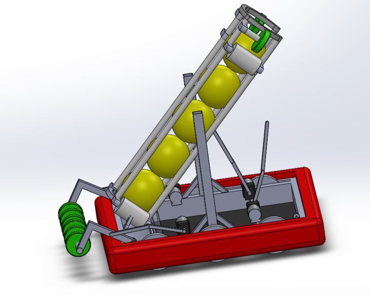

So my team was planning on using a Dart Actuator from AndyMark, but they appear to be out of stock now.
So we are looking for a similar alternative.
I saw this one suggested in another thread: https://www.firgelliauto.com/products/linear-actuators
But it looks like it will only fit a BAG-sized motor. We are planning on building a “tube” which holds 5 power cells and tilts up and down. It will weigh around 15lbs and the actuator will be connected around the middle of the “tube” to the back of the robot. I’m worried that that one will not be fast enough.
I also found this one: https://www.firgelliauto.com/collections/linear-actuators/products/deluxe-rod-actuator
Does anybody have any experience modding these to fit FRC-legal motors?
How difficult is it?

humm… what is another type of motion do you recommend? Our team is kinda running out of time for build and we are running out of ideas for precise linear motion. We talked about air but for our bot design, it will not work. I am a Build lead on 4557 and I really don’t want to use a mechanical device (LA) that is trashy as you seem to be implying. The issue I am having rn is time, resources, and cost. The LA get over all these issues, because we have one on hand, but might cause many more down the line. Thanks for your help! I am looking forward to seeing any ideas you might have.
Pretty much every implementation of the DART seems to be in an arm, or something that is fundamentally rotational and not linear motion. The classic sprocket bolted to an arm driven by a high reduction gearbox was my team’s go-to, both for reliability and cost. The OP described what is essentially an arm, but I’m not sure what your actual mechanism is.
Ok, so we did consider that design but were worried about how much flex would be in the chain. Our design is building a “tube” which holds 4-5 power cells and moves up and down. It will be long and we are worried about the small “play” in the chain being magnified because it is so long, which would have a large effect on our shooter accuracy. I do not have much experience with the amount of play in a chain setup like that, but I am assuming it will be large.
Rough CAD. The design has changed a lot but principal is the same.
Why does the arm need to rotate? My first instinct is to say if you don’t have machining resources more precise than saws, you should not be trying to make an adjustable angle shooter. We fell into this exact trap in 2016 (literally the same thing – trying to use a linear actuator to move an arm up to shoot at variable angles) and it didn’t end well for us. We had issues with sensor calibration, lead screws failing, low tolerance machining resulting in inaccurate shots, etc – and we could have performed a lot better that year had we just either gone for the low goal or a fixed high point shooter. Consider how many variables you have to tune to get this working even assuming no part failures.
If you really want to stick with this concept, the large sprocket on the pivot point could work. Since the arm doesn’t have to rotate by too much, you could use a turnbuckle on one side of the chain, similar to how you may have seen teams tension elevator chain in the past couple of years. So long as that turnbuckle doesn’t pass over either sprocket in the full range of motion of the arm, you should be able to take out the slack in the chain with this method.

Do you need more than 2, 3, or 4 angles with this design? Pneumatics would be an easy way to accomplish changing the angle with such a mechanism. I would figure out the points you plan to shoot from on the field, see how many angles you actually need, and then design a cylinder based solution around it.
If your shooter is adjustable because you plan to shoot from “anywhere”, I would take a step back and do some strategic analysis to figure out where you are actually going to be firing from.
We want it to rotate for a few reasons including staying within the frame and also aim adjustment depending on location of robot on the field. It allows us to shoot high, low and pick up from the loading station on the ground and up high because of the variable arm extension.

We do not have access to a massive machine shop with cnc and such but we do have a fair amount of resources including an old Bridgeport and a couple band saws and the likes. We have the capabilities to do a lot more, we are just trying to find the simplest and easiest solution to our issue that will work well.

Wow! That design looks really similar to ours. Great minds think alike :slight_smile:
In that CAD, it looks like the “tube” is being driven from a four-bar linkage. Is that something you guys are still considering?
