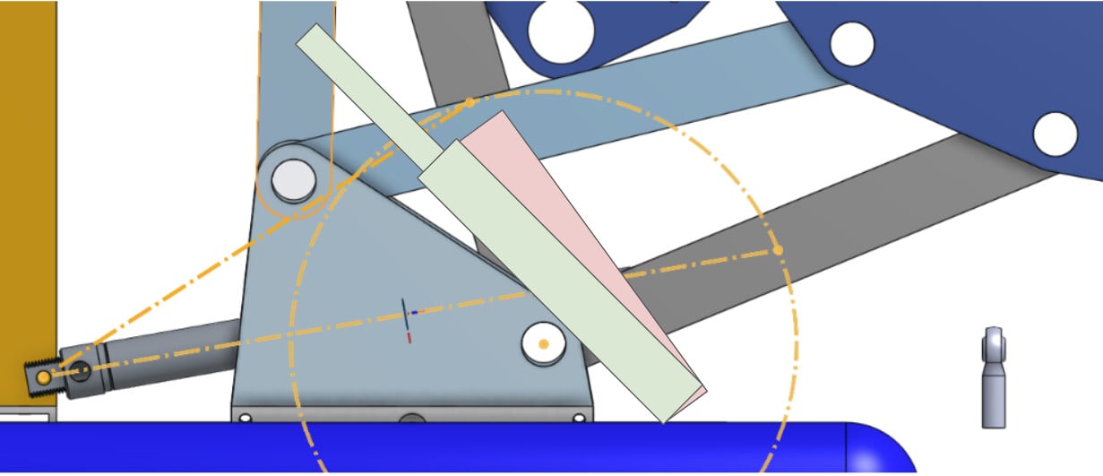

Going back to this thread. Thanks all for the responses before. I think I’m getting closer. Here’s a picture of my current cylinder placement vs. one of the arms of the intake I’m working on:
The angle’s good for pushing the intake out, but the angle between cylinder and arm is around 12 degrees for bringing the intake back in… not very good, but should it still function? I’m using 4" cylinders because we have 3 matching ones in inventory unlike other sizes. It seems like it might start slow and jolt back when pulling the intake in… Unfortunately, there probably won’t be time to test it, so I’m looking for a little help from experienced eyes. Thanks.
At 12° you will only have 20% of your piston’s strength. Will that be enough?
Consider adding some surgical tubing to assist with the intake weight…
Is it possible to mount your intake piston like this? (red is retracted, green is extended)
This has the benefit of a much larger lever arm for your piston to push with (primarily when you’re putting it back up, which is when you need it) and keeping your piston more protected when the intake is out.
Second the reply above, though. If you need to operate with such a small lever arm, counterbalancing the intake will be a necessity.
Looking at reca.lc, I see the retract force of two pistons is 88 lb-ft, and 20% of that is 17.6. I’ll guess the intake will weigh 5 to 8 lbs, and most of that mass that needs to move is in the neighborhood of a foot away, so it seems like there should be enough strength.
What about stress on the arm? I’m thinking of making it thicker.
EDIT: Seems like reca.lc’s force calcs may not be right. I used this calculator instead and got a 2 cylinder force of around 47 lbs.
Yeah, I wanted to do that actually - I saw others doing similar. But because of other stuff on the robot, it didn’t work well. Maybe I’ll take another look at doing that.
I decided I’m going to elevate the cylinder mount to get better angle and accept the cost of more material & weight to accomplish it. I looked again at the option Nick mentioned, and can’t get it to work. I also looked at using a counterforce from a gas shock, and it could probably be made to work, but I’m running out of time, so I need to keep it simpler. Thank all.
