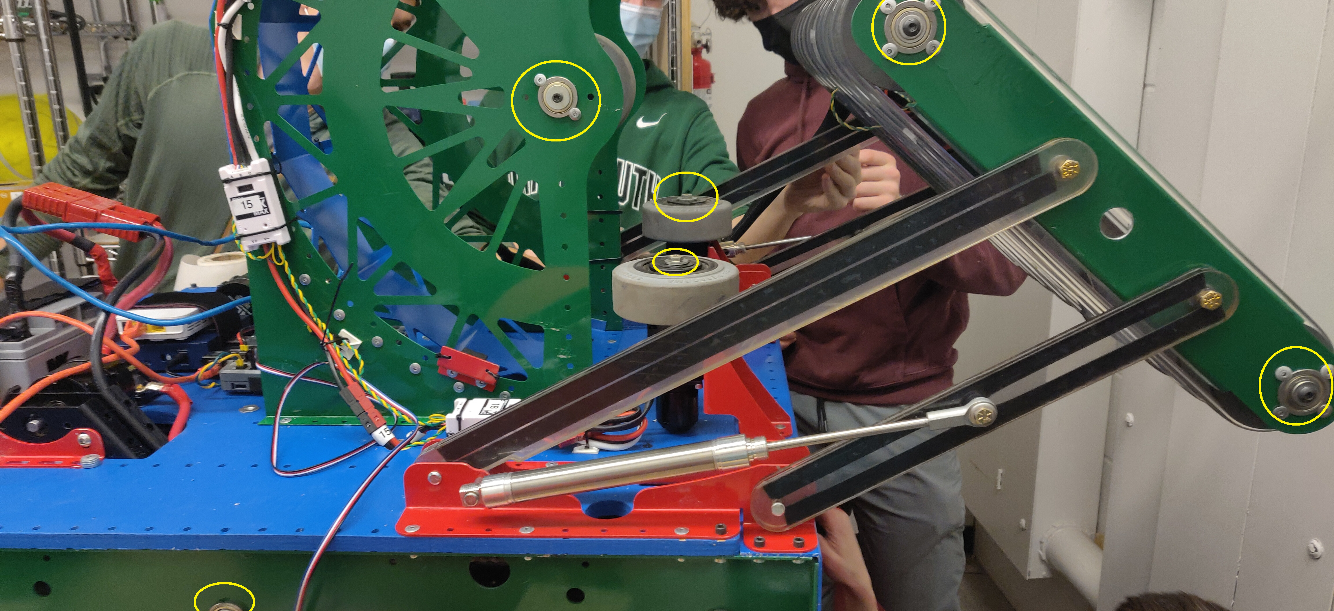

Hello, we are looking to use a Versaplanetary 1/2" hex shaft and instead of using a lock collar, we want something that is a smaller profile. We were thinking of using a washer and a flat head screw, but this is going on top of a bearing. Does anyone have any other suggestions? Thanks!

We use washers and a 1/4-20 bolt (I think) into the end of Thunderhex. We tap the hex. As long as you use a washer which is not too big (only covers the rotating part the bearing), it works fine.
A washer and a screw into a hex shaft to retain a bearing or wheel is just dandy.
Here are some examples from our 2022 robot:

In all seriousness, loctite is definitely a requirement for the screw and washer method - the screw will actively try and back itself out, and you’ll need to check on it periodically even with Loctite
