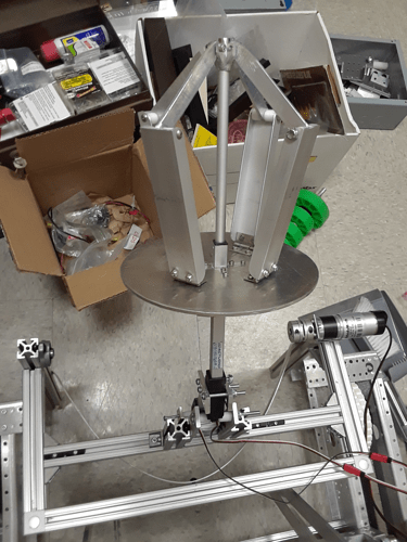

Are you using the Logitech “fakebox” controller that came with the Rookie Starter Kit? If so, do you know what numbers correspond to what buttons? I got this from my last post, but it is not accurate with our controller; for instance, our A button is 6, not 0. Is there a way to set those numbers somehow, or a place where I can see them all?
Do you use AndyMark actuators on your robot? The .set() method of the Servo class does not seem to work for us, even when we put it in RobotInit rather than a button press.

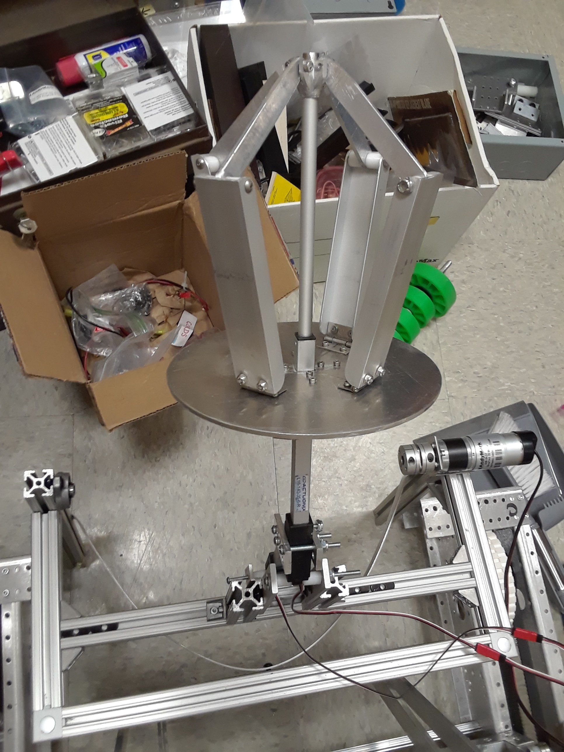

What do you mean? For the buttons, they give an error in the RioLog when they are not set to the correct number. For the actuator, it just doesn’t work. Here’s a picture of it:
That is a very good point. I don’t think it’s the problem, because we tried the .set() in the RobotInit not tied to any buttons, but it was definitely a problem. Thank you!

Waz’s suggestion is an important one to make sure to implement, but since you said it wasn’t the full cause… Try instead of putting the code in robot init (since most controllers are disabled when the robot is disabled) put it in teleopInit and do tulip.set(1.0); If that works make sure 0.0 works. If those do then it must be something with the triggering code, if it doesn’t work then it may be electrical or mechanical.
