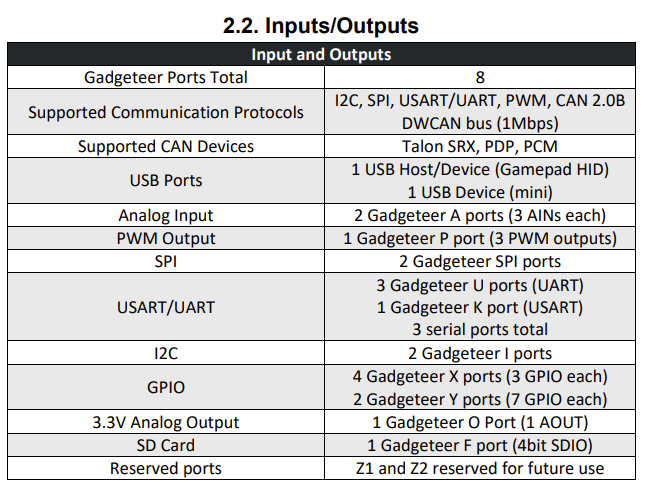

The problem with older robots with no CAN motor controllers is the HERO board only has 3 PWM outputs, Picture of I/O and COMM protocols below

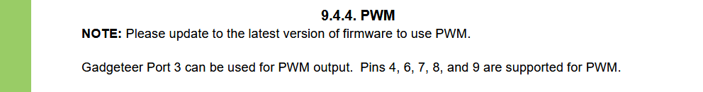

Just to clarify, the minimum spec for Gadgeteer requires the 3 PWM outputs listed but HERO actually has 5 - we were able to fit another couple outputs in.
The full HERO-specific list is in the PWM section:
That’s still nowhere near what a roboRIO has available for PWM, but combined with some PWM Y-cables you can stretch it pretty far for demo/development robots.
