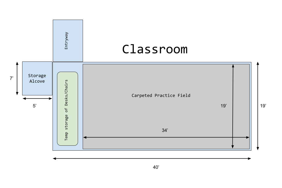

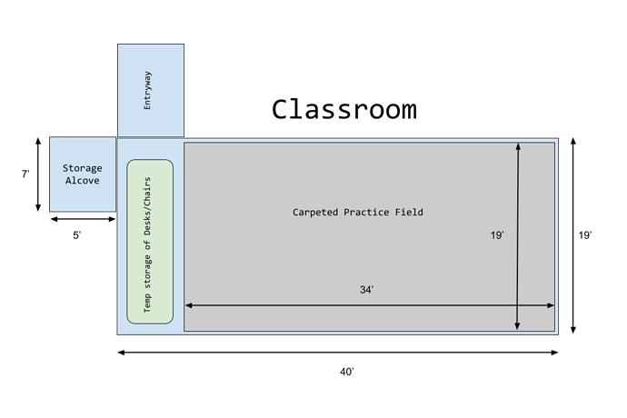

We are currently using a classroom for driver practice/autonomous testing (layout below). The room must be re-set to “classroom mode” at the end of each session.
The previous method (unroll a marked carpet, place game pieces on top of it, add some tape around the edges) just can’t hold up to the reaction forces from a swerve drive robot. (think carpet that looks like lasagna noodles)
Have you had this problem and found a solution? I’m currently thinking along the lines of 4’x8’ sheets of 1/2 ply with carpet stapled on to them. Get’s laid down on the floor and then stacked up at the end?

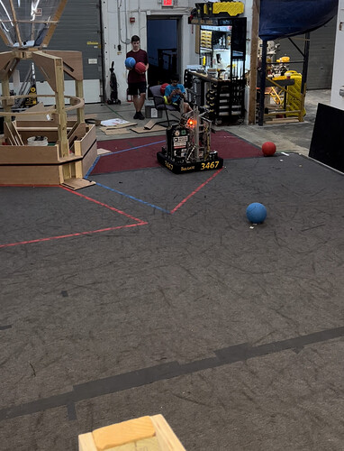

We rolled out new carpet at the end of January and will need to replace it for next season.
This picture is from right after champs and we have a lot of new rips as we’ve been training more drivers. Been tape patching an dead heading runs as much as we can.
Our space is about 25’x40’ so we are ripping up a smaller area than a full field of carpet. I would attribute a lot of our damage to first year swerve + using black tread.
