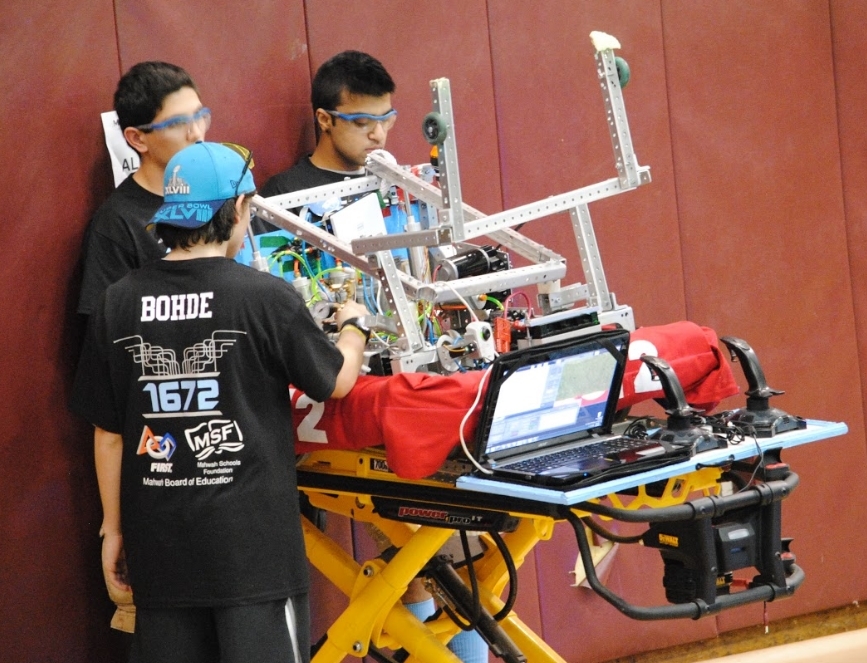

1672 is very lucky to have a Stryker stretcher from back when Stryker sponsored us. Their headquarters is in our hometown but they unfortunately cut our funding.
