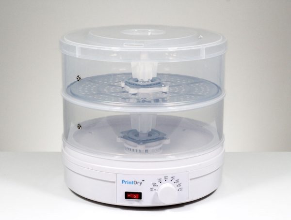

My advice, get one of these:
Best $100 I ever spent.
Unless you live somewhere with like 0% humidity, odds are your filament will absorb moisture, which tends to degrade print quality. PLA and Nylon are especially vulnerable to this, and it’s important to keep them dry when storing them for extended periods (though the length of time before you start having issues will vary depending on your climate).
Load one of these up with whatever filament you’re using and you can even dry it while you print with it. Add some old desiccant packs to the tray and the spools will stay dry longer, even after turning it off (dryers like these can also “recharge” desiccant packs).
There are other solutions out there too, but of everything I’ve tried, these have been the most reliable and consistent. In theory you could use an oven or similar appliance too, but often the temperature regulation on such devices is not as accurate and can result (speaking from experience) in melted spools (plus, I personally have no desire to have plastic cooking in my food oven), so it’s better to have something made for purpose IMO.
