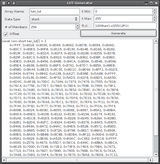

I had some spare time yesterday (gasp!) and decided to whip up a GUI for lookup table generation. (We seem to be making a lot of those.) Manually editing and compiling the Java app I had whipped up earlier in the season was getting annoying, so I decided to make an end to that. :smiley:
A screenshot is attached (running under Linux). Note that this program is a little abnormal to install, since it requires either Mono or the .NET Framework v1.1. If using the .NET Framework (which I would reccomend under Windows), the Gtk# libraries. (Sorry folks, but I didn’t have time to install VS.NET, and there was no way I was laying the thing out by hand. Plus I’m a Linux geek. 8)) So here’s the instructions for getting the respective libraries:

No, no graphs. Let’s say that you want a lookup table for tangent (just like in the screenshot I attached). You want input values of 0-255 in increments of 1, with 0 being itself and 255 being 2pi. (This program uses radians, btw.) So your function would be:
f(x) = tan((x/255) * (2pi))
So you enter that function, click generate, and bam, there’s your lookup table.
Or, just to illustrate my point, you could do this:
f(x) = x
And it would generate a lookup table of {0, 1, 2, 3, 4, … 0xFE, 0xFF}.
Sorry if I’ve been unclear, or I’m writing this too fast… I can try to explain it again if you don’t understand, or you might want to download the program and play around with it a little.
Thanks, this is going to save me a lot of time.
Beautiful. Thank you so much, R4v3! Be my valentine!
Basically, if I may elaborate, it takes a math function of any sort, and generates the applicable, integer values, in hexadecimal, into a lookup table of your choice. Eliminates syntax errors and you having to type in 5000 values by hand… Looks good! (Wishing I had this two weeks ago…)
