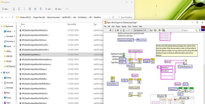

The motors are now fed into an array then to the drive VI
Sorry for the broken wires, trying to keep it small. The broken wire would have been plumbed to LeftMaster. Followers have been removed for brevity.
The vi’s are still in the library and can be dragged into your project from there.
There just isn’t an entry in the pallet to drag them from.
