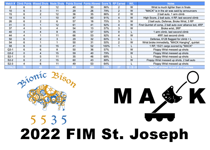

Just to add some insight to our run at St. Joe, here’s our breakdown post-comp. Biggest flaw in our design is the wrist being sloppy/gears breaking after running a lot. Once we get that nailed down, our ends should hopefully be better.
