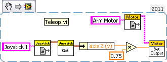

How do we lower the speed for a motor using a victor jaguar. We are using this motor for a robotic arm. We are using LabView.

Then (I don’t know LabView) but give the Victor a different value. It should be something like -1 to 1, with -1 being full reverse, 1 being full forward.
Something like .5 would be half speed.
Depends on your control method, but you can multiply a Joystick axis value by a percentage (e.g., .9 or .75) before it goes into the Motor Set Output.
Then max power will be limited (e.g., to 90% or 75%).

Thanks for the advise. We will try it.
