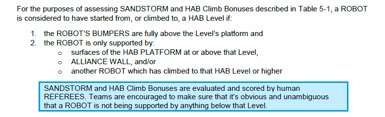

Is gripping onto the side of the wall not considered a level 3 climb for the robot? For example like snow problems climb on youtube would that be counted as a lv3 climb or not ? Thank you for the help :slight_smile:

To clarify a mechanism that grips onto the side of the lv 3 habitat platform would not be counted as a lv3 climb correct? Sorry for repetition, I want to clarify and have a positive answer.
I am not entirely sure, but that is my interpretation. Presumably, you could tip on the platform and then release.
In the case where you are simply resting on top of a platform, but part of your robot is touching the side of the level 3 platform, but not gripping it, this to me would likely count as a level 3 climb with all other criteria being met. But some refs might interpret this rule differently, so you probably should try not to be touching the side of the platform.
If you let go of the sides so your robot is only supported by/touching the top plane of lvl 3 then it should be a legal climb.
I’m pretty sure that does satisfy all of the requirements for being climbed, but I’d encourage you to check the requirements for being supported by the hab platform yourself to make sure
Re: Q108 from FRC Q&A and Section 5.3 Scoring
Make sure that when you attempt a climb to any HAB level, your bumpers are fully above the HAB level top horizontal surface, AND supported by that level or by a robot supported by only that level or the alliance station wall, AND that you are not in contact with any surfaces at any point below that level.
If a referee has any doubt as to you are fulfilling ALL the requirements you will not get the points for the HAB level you were attempting to reach. There is no instant replay or review of any sort once the head ref’s call is finalized and scoring is submitted.
TLDR: Make it easy for the head ref to know your bumpers are fully above the HAB level you are climbing to, and that you are fully supported only by the top horizontal surface of that HAB level (and possibly the alliance wall). Do not have any contact below that level, and do not have any dangling or hanging parts that can make contact below the HAB level you are attempting to score at.

I corrected your first statement. Contact is acceptable. Support is not. Once we correct that, the second line is also accurate.
The third line is not true. There is a question box that teams are encouraged to send one student to discuss the ruling with the head referee. Scores can be changed as a result of such conversations. Let’s be clear the word “can” does not have the same meaning as “will” and it’ll be very difficult to convince the head referee the robot wasn’t supported if they or their referee making the call believed it was supported. But, it’s erroneous to say it cannot happen. Even once the scores are submitted changes can be made.
Because a person is unable to determine if any contact is resulting in support or not, you should avoid having any contact below the HAB level you are attempting to climb, or assume you may be scored for the lower level.

To your first point, it’s a tad insulting to ALL people to suggest that nobody is capable enough to look at some situations and determine if there is support or not. Will some be borderline? Sure. But, that doesn’t change that your wording was incorrect. Your advice is good. If there isn’t any contact, there isn’t any question. But, it’s possible for pieces to be touching the side where there also isn’t question as to whether or not there is support. Think about it as “can’t” and “shouldn’t.” You originally stated you can’t, which isn’t true. Your logic states you shouldn’t, which is entirely true.
^^ this. Read Q&A 108. The best plan to completely disengage from those vertical surfaces.

The examples aren’t as disconnected as you believe. At the point the referee makes a determination, it becomes definitive. It was supported or it wasn’t. Can a team predict how this will be viewed? No. But, it isn’t any different at that point. While it’s “clear” a team crossed the line (this can also be a bit blurry with things between the referee and the robot), the team arguing cannot bring anything to show this happened. At that point, they’re asking a referee to remember what happened. In the same process, they’re asking a referee to take a look at their memory and see if they believe there was contact or support. Are they likely to win this? No. But, it’s not impossible.
Here’s the issue. You’re not arguing for what you stated. You stated you cannot get the points if you’re touching. That’s wholly inaccurate. You’re arguing that you shouldn’t do so to avoid ambiguity. That’s something we’d agree on. But, there’s a very big difference between “can not” and “should not.” Your example didn’t show that to be untrue. You’re still incorrect. You can get climb points while touching the sides. You’re still correct. You shouldn’t design in a way that leaves things in the hands of someone’s eyes from a distance.
