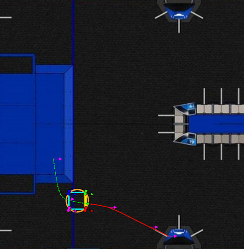

At this repo, you can find our 2019 offseason code. This consists mainly of a pure pursuit path generator and a 2 dimensional swerve drive simulator, along with a labview program to parse the paths generated by said program. I also threw in a simple data augmentation script we made for use in Deep Learning.
^And this is why I keep doing this program year after year. Kids like this. He doesn’t like to brag, but this boy wrote all this code BY HIMSELF AS A 10TH GRADER. No mentor intervention (mainly because we can barely understand everything he keeps doing), but pure research and development over countless hours.
