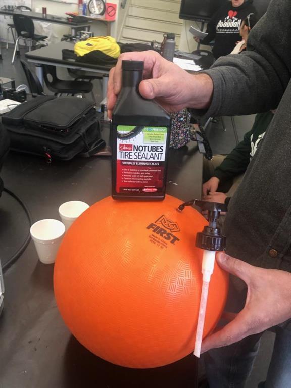

MacGyver'd our leaking cargo ball

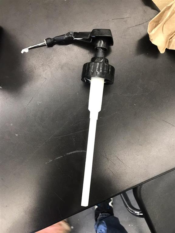

Our two cargo balls had unfortunate encounters with splinters. The quick fix involved Gojo hand soap pump, shrink tubing, ball needle, and Stan’s tubeless bike tire sealant (no, we didn’t have the Stan’s injector/syringe). One of the holes started spitting out sealant for a while, then spontaneously plugged itself up (whew!) and both have held air for the last several hours.
