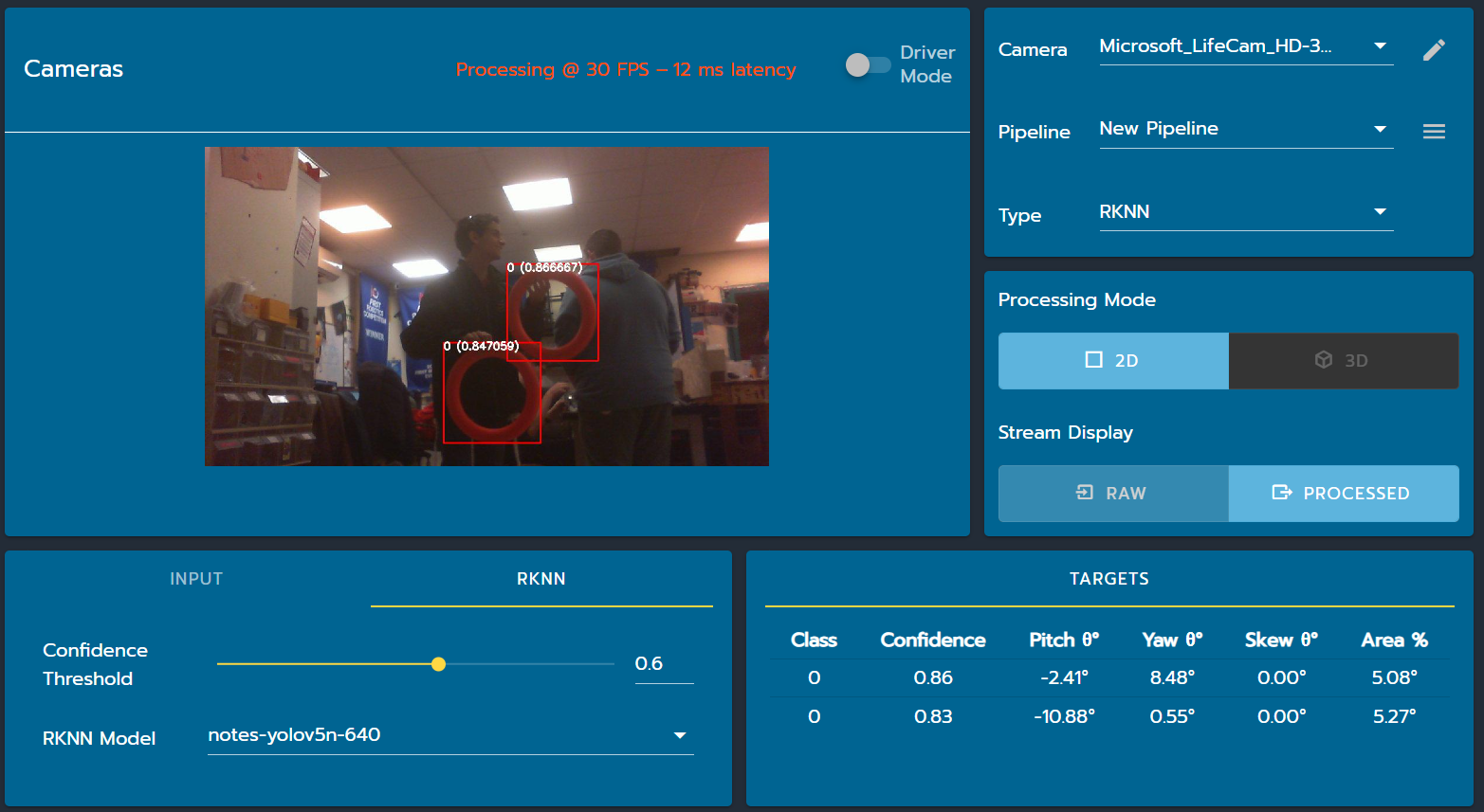

This only runs on an orange pi, not rpi 5, idk what pi 5 op has. Otherwise you could run a color detection pipeline for the color orange, it’s easier and would work fine as long as you tune it to not see red bumpers.
Yup my bad, I misread OP referring to an orange pi. Kinda forgot an rpi5 is now out.

Please note that this fork is unofficial and users won’t be technically supported from the PV team (we don’t know if the code has deviated, what changes have been made, etc.)
PhotonVision also now supports orange pi based model detection as well.
