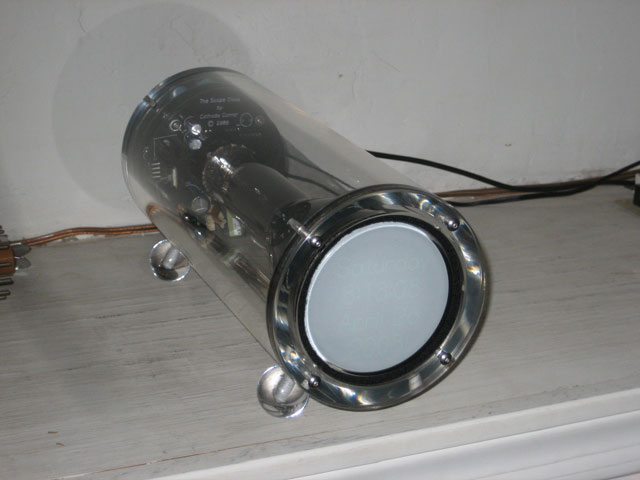

You can make some really neat things with acrylic.
oblique
Of course these are things you want to leave sitting on a shelf, not driving around being bashed into by 150 lbs of robot!
