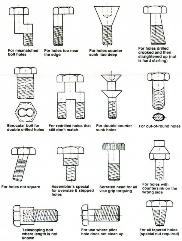

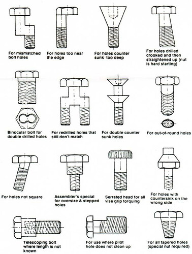

What is this foreign concept of accurately machined bearing holes?
For a 1.125" bearing, yes, that would be the correct size. Anything 1.124-1.122" should be good.
Edit: sorry for machining size that we intend to ream, we use 1.100"
You totally can do it, but then you are actively needing to deal with tool deflection, cutter wear, finish quality, and how rigidly your part is set up for everything you do in order for it to be repeatable.
The true fix is finding some alternate options for bearings, ala this selection of bolts:
