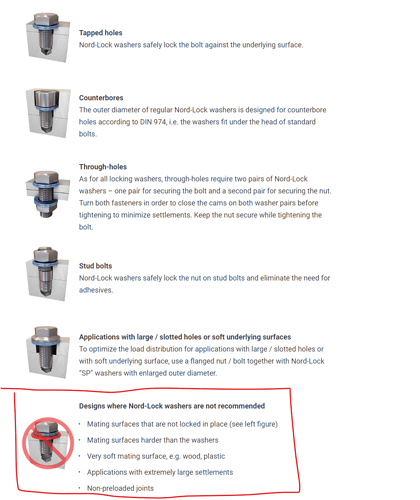

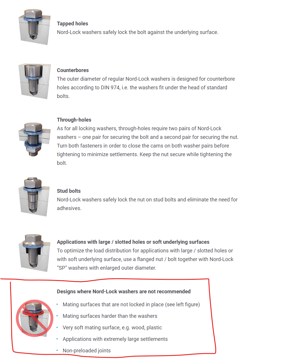

all these top “recommended” cases do not have a washer (we can think of a lug essentially as a washer) involved. You can see that using nordlock washers in combination with another non-locking washer is not effective from the bottom case. Intuitively this is because the nordlock washer can only prevent rotation between the two thing’s it’s touching. So when a normal washer is placed below a nordlock washer, sure, the washer won’t rotate relative to the screw, but the nut can still rotate relative to the threaded studs. i think @IndySam is probably suggesting putting an additional nordlock below the lug (washer) to mitigate this effect, but i would be skeptical about the conductivity of the nordlock washer in this case.

If the lugs are constrained rotationally by some other means, then a single wedge-lock washer is appropriate by the manufacturer documentation.
Most square lugs are constrained rotationally by the breaker body itself as well.
Isn’t this case closer to “Stud bolts”? The not recommended case is where you put a nordlock on top of a regular washer.
but i don’t think the ones used in FRC are right? I’ve never set up a FRC breaker like that at least.
no, the difference is that in the washer case there is something touching the nordlock that isn’t rotationally constrained (the washer, or in this case the lug).
you can see in this video that the “no washers” rule is intended to be generalized to all the listed valid use cases, not just the “tapped holes” use case.

I wouldn’t do it like that for 2 reasons:
  1. The through-hole example is for clamping two pieces of material with two fasteners that can spin (nut and bolt). In our situation the stud can’t spin, and the goal is to clamp the lug against the breaker. I think our situation is more akin to the stud bolt example.
  2. Most of the electrical connection between the breaker and lug comes from direct contact with the metal pad at the base of the stud- putting a nord-lock there would significantly degrade the electrical connnection.
