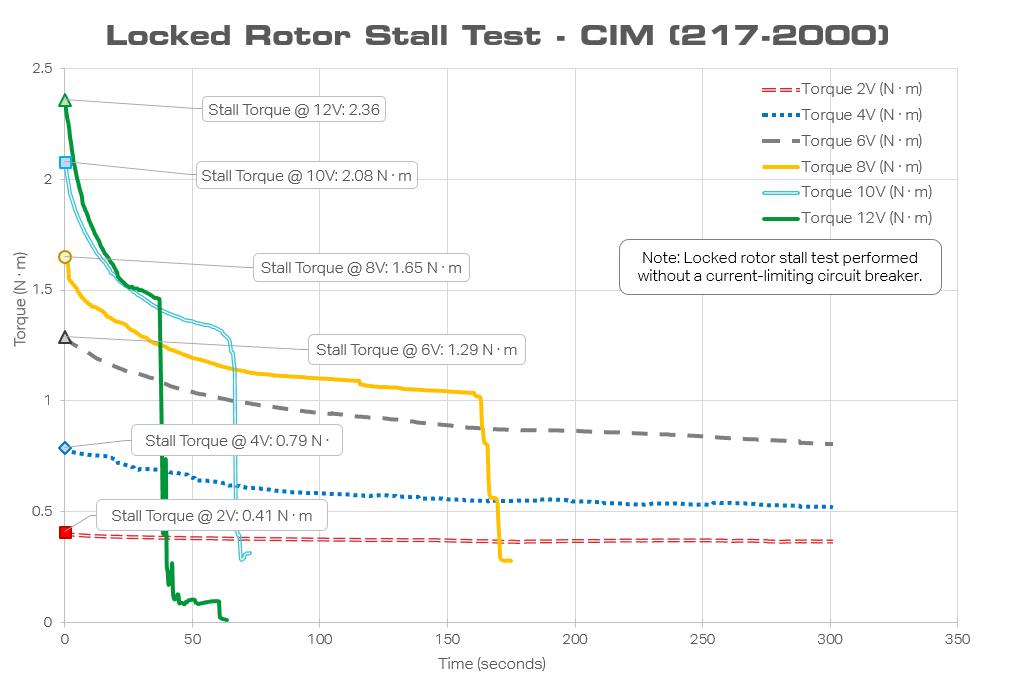

For example, here’s a CIM motor’s locked rotor stall test data:
At 6 volts, the CIM motor’s output force degrades, but the motor can keep running for at least 300 sec straight.
At 8 volts, the CIM motor fails after ~175 seconds. Higher voltages cause it to fail faster.
The exact numbers will be different for different motors, but the end result is the same: Depending on the situation, this may or may not be a viable strategy.
