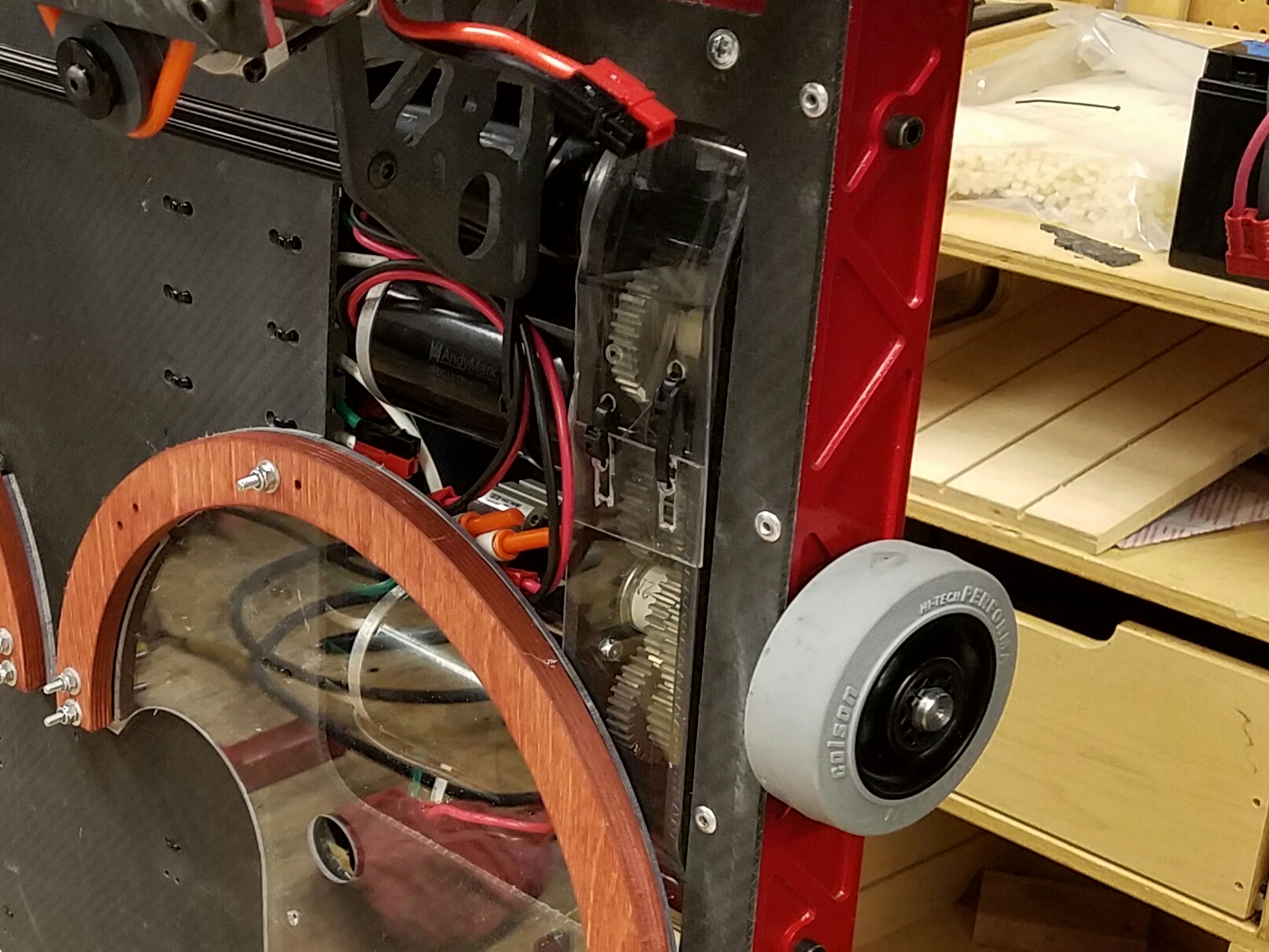

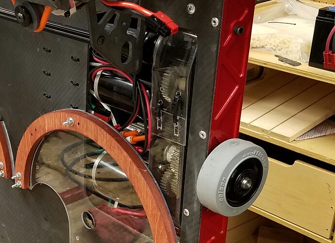

We built custom gearboxes this year, and made bent 1/16" polycarb covers that wrap all the way around the gearboxes and tie-wrap closed at the top. The gearbox is incredibly close to the ground so this cover was a necessity and it has done a great job so far.
Attached is an image of the solution.
Chain-in-tube?
Yes, I forgot to mention that. This drivetrain was highly influenced by the need to save space, but it also conveniently helps protect our chains and gearboxs.
