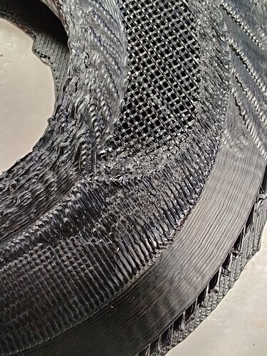

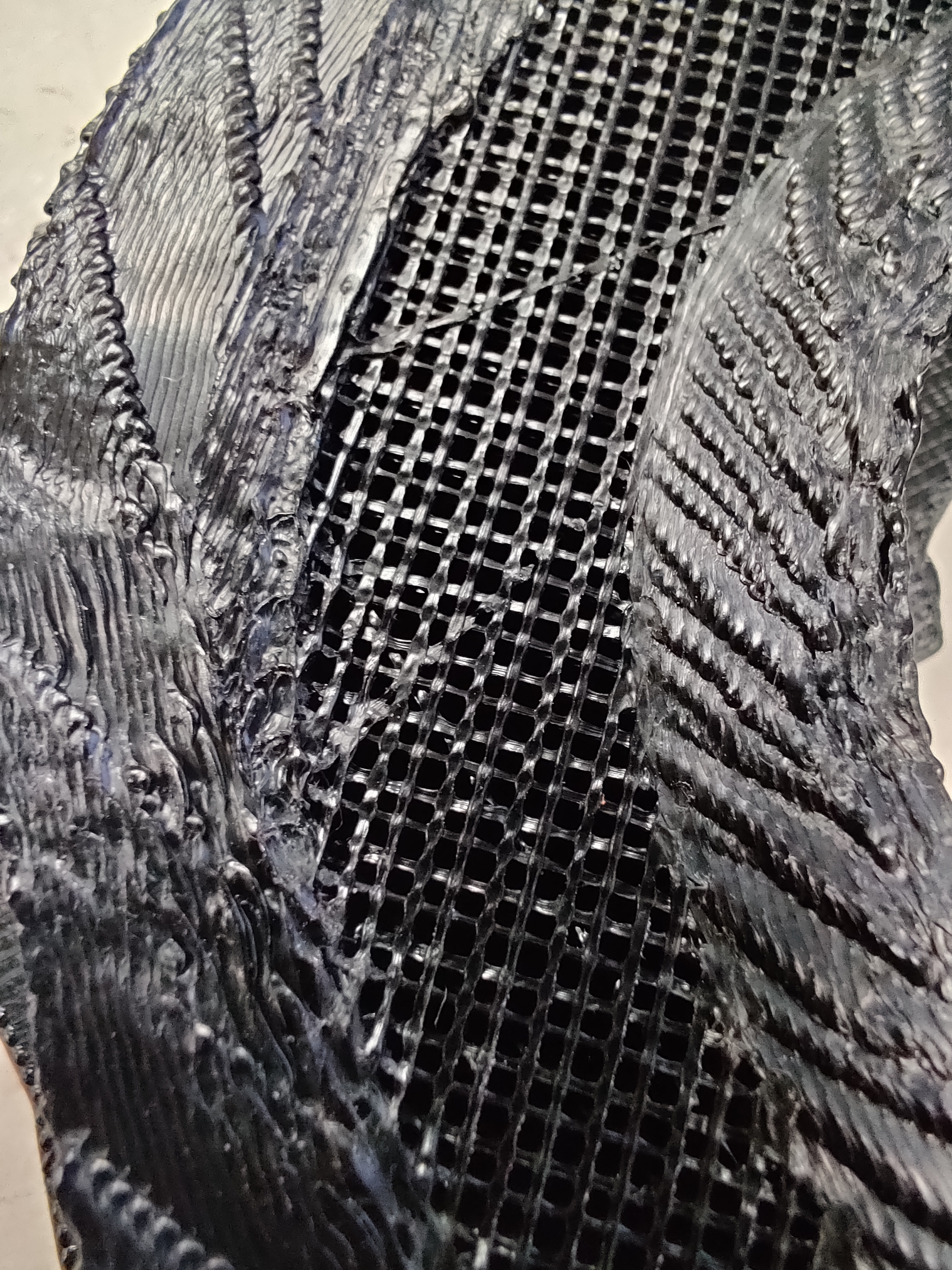

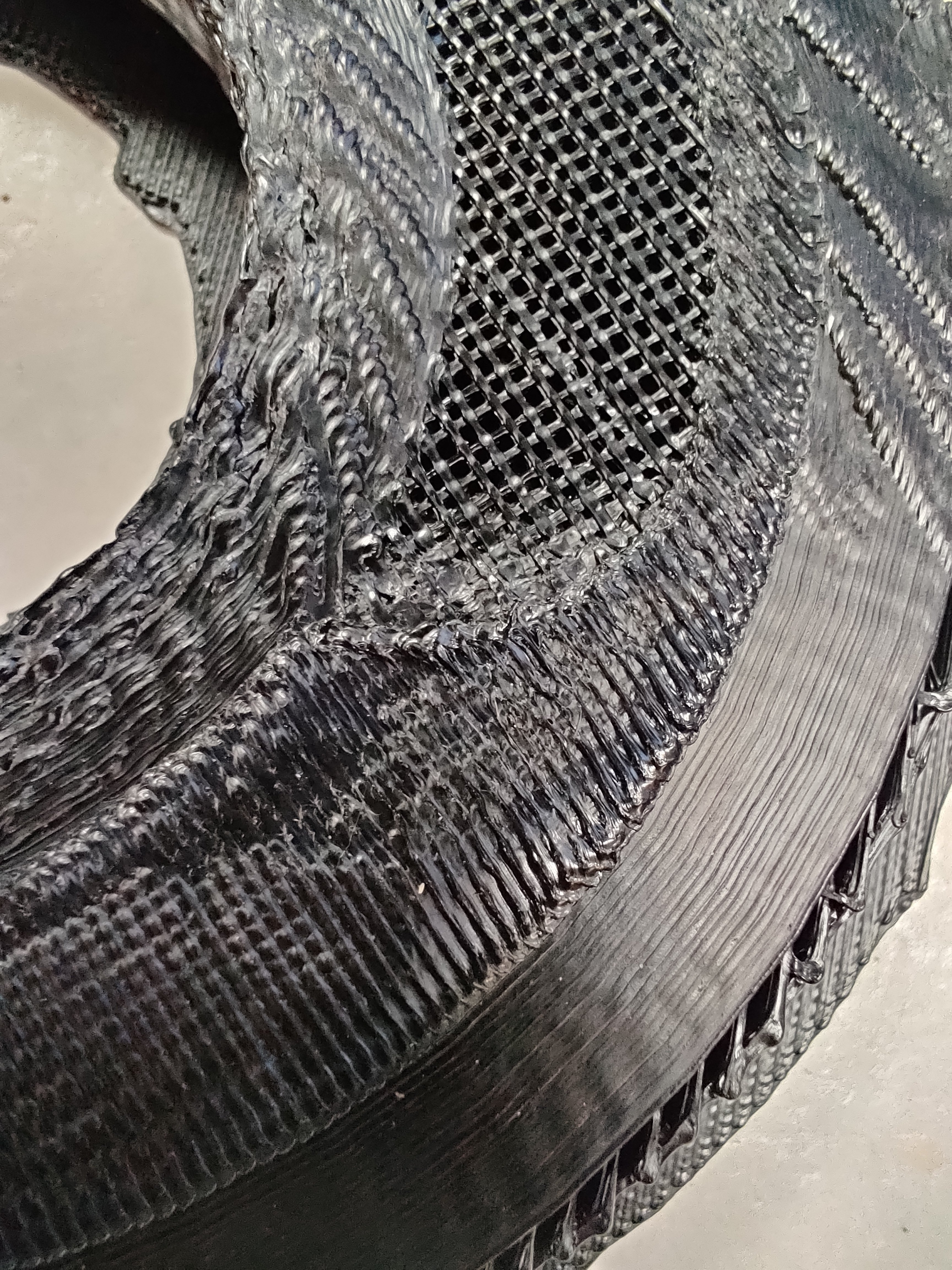

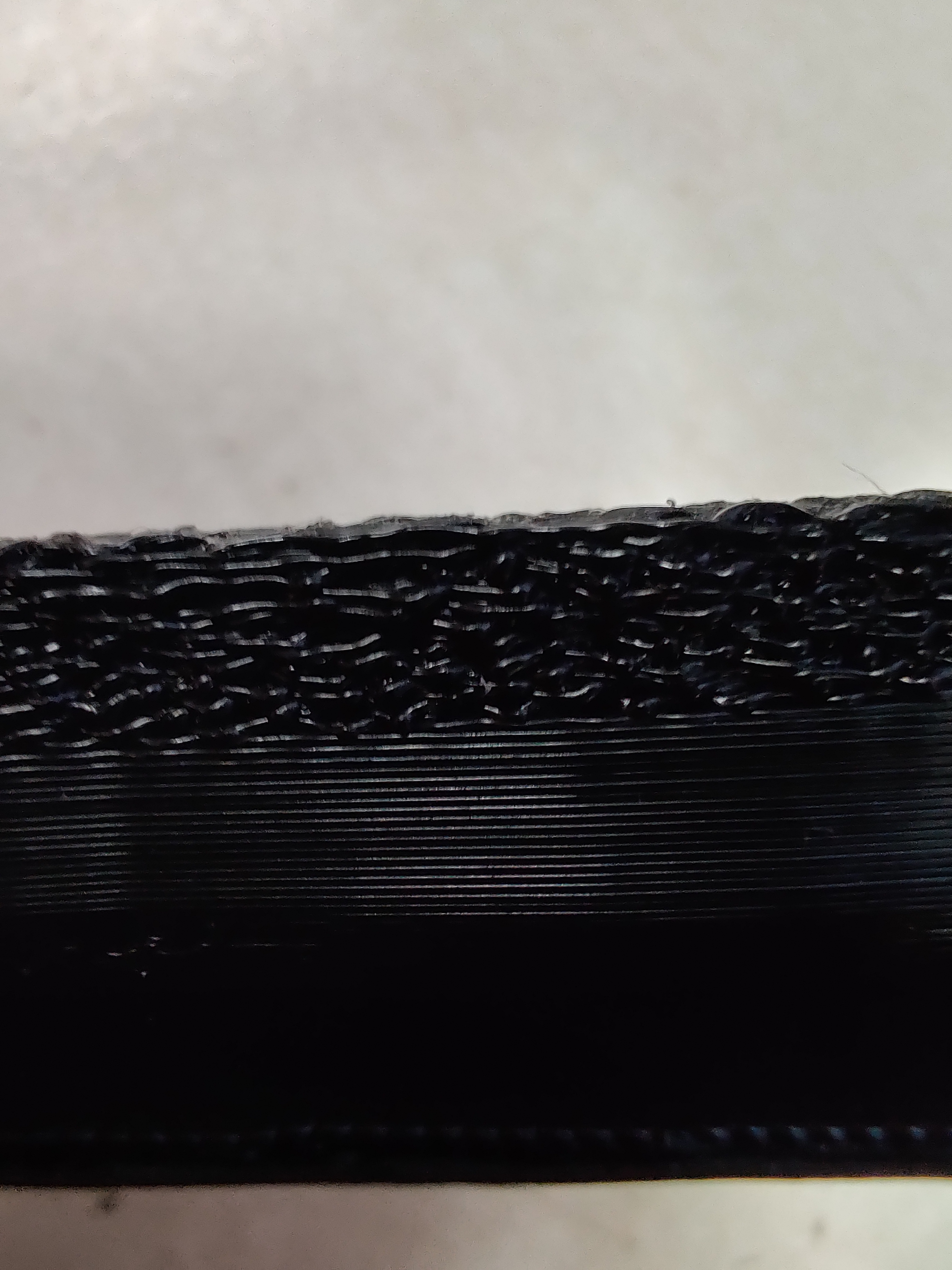

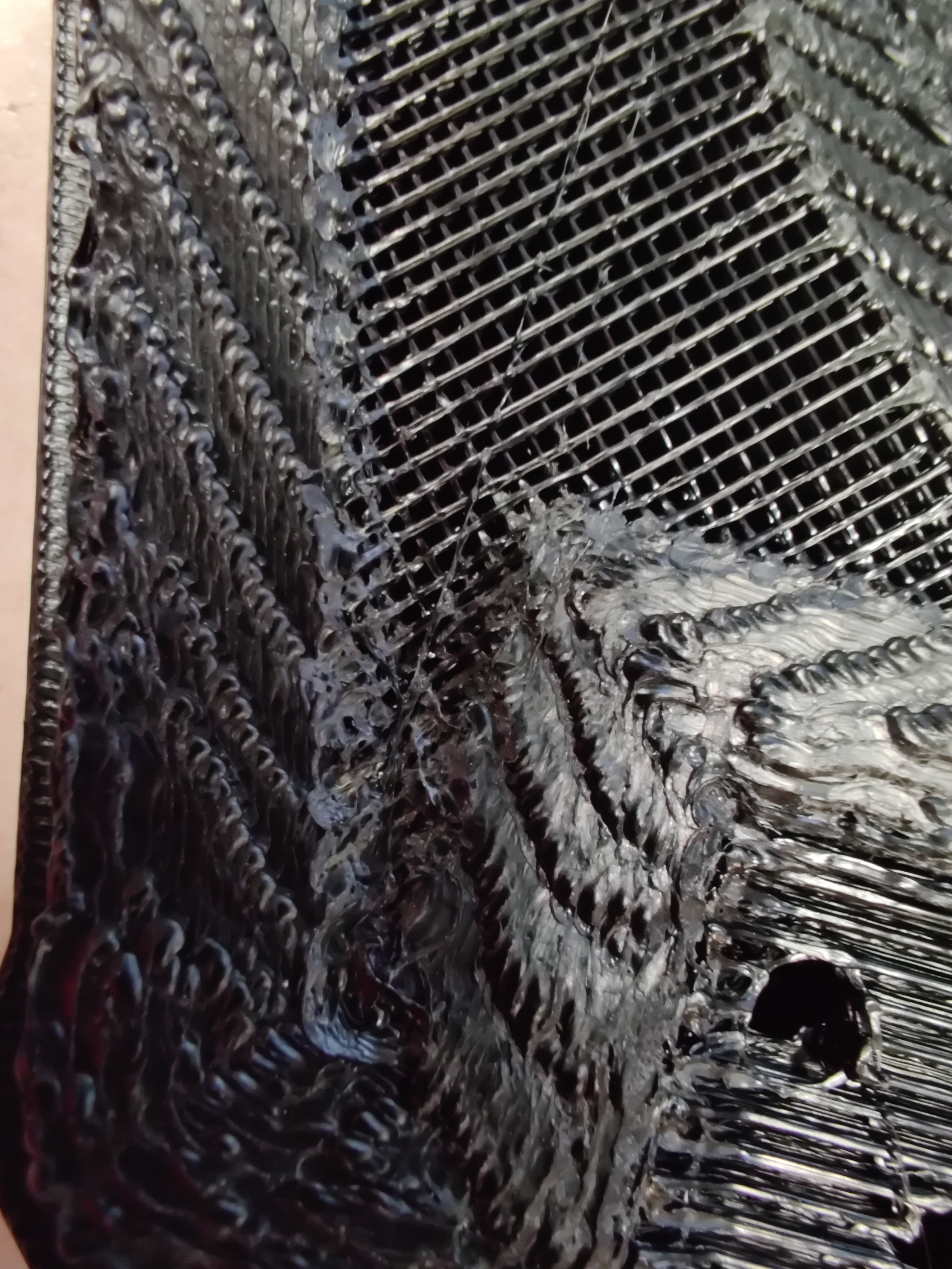

Printer is enclosed and these settings have been used on other parts with no problem. Print settings are the same as many successful prints, except we are setting it for 8mm walls and 30% infill. It seems like the first few layers go fine, but then the wall section ends up higher and messy in certain sections (as you can see from the side view picture below). It’s very strange and I am struggling to figure out why. I’ve attached some close-ups and am hoping some of you might be able to help me figure this out…

Also, I would direct your attention to the third photo I posted up above - notice how the 8mm thick wall is fine on the right side, but then as it goes up, you can see where it all gets super thick. The walls were actually about 1.5-2mm higher than the infill by the time I stopped the print, but perfectly fine in that one section.
Are you able to modify the filament size in your slicer? It looks like it’s over extruding to me, and (maybe based on the wall thickness and part geometry), it’s not noticable until quite a few layers are laid down. If this is the case, you could use thinner walls, and (potentially) start seeing it higher up, or thicker walls and see it lower down.
i would agree - 8 mm is very thick and if there is any overprint then you could have that problem. I also noticed a problem with my TAZ 6 with thicker walls and it was not squared quite right and only showed up after 1/2" of print height (although if you are using two different printers then likely not it). If you share an STL file I could confirm and review with Cura slicer as well.
