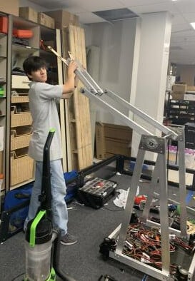

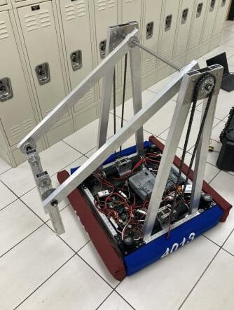

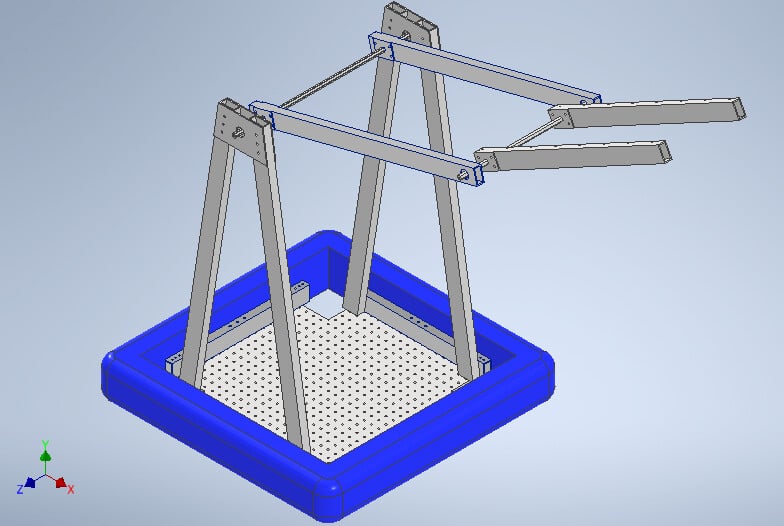

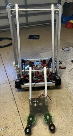

This year, my team (4013 Clockwork Mania) came up with a design for an arm with two joints. I wish I had the official CAD for it, but it was on a laptop that unfortunately did not survive an incident involving a flying tape measure (this was outside of FRC, don’t worry) However, I was able to find this really old concept from when we first started designing.

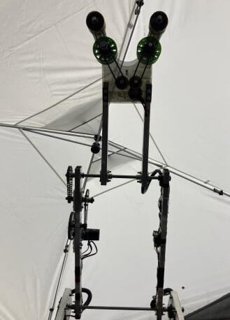

The idea was that the two sections could rotate independent of each other, and the shorter section (that has an intake at the end) could pass through the robot as a whole. This meant that we could pick up cubes at any height, place them at any height, pick up cones from any height and orientation, etc. If we picked up a tipped cone that would be upside down when raised, we would just have to pass it through the robot and it was suddenly ready to place.
The joint for the larger section has max around 150 degrees of rotation, and the joint for the smaller section has a bit more than 360 degrees, basically a full rotation’s worth of freedom but not continuous because wires for the motors running the intake run through the entire arm mechanism.

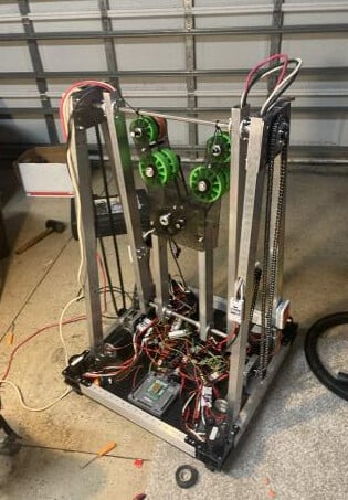

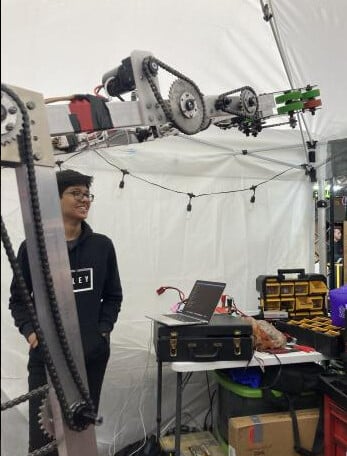

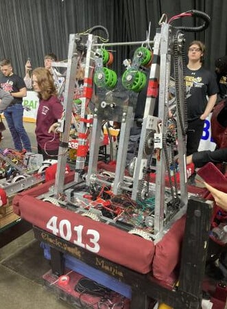

When we built it, it worked! (mechanically only tho sadly). Our team didn’t have a mentor in that era (we had supervision in the robotics room and someone registered us) but we didn’t really get any help aside from that. On a very similar and important note, at the time we didn’t have the resources to properly execute the design. Specifically, we didn’t have any VPs or gearboxes strong enough to run the arm. Eventually, we ended up making bigger reductions with adding more stages and sprockets and chain. It was a mess, and extremely ugly, but the arm held its weight and more. It was still struggling though, and the sprockets we used at our competition were mostly borrowed from other teams, so we had to disassemble the source of our gear ratios.
This year, we have a mentor and more resources. My main question is, how would you best manage creating enough torque in both arms with a design like this? The less chain, the better.
We are planning on attending an off-season event this October, and want our arm to be scorable. Obviously it doesn’t have to be world class, but we want to at least accomplish something with the many hours of headaches and daydreaming that went into this robot. I know it’s possible, as we got it to score a bit on the practice field (albeit janky) but I would like to know how some of you would tackle this if you were faced with this design.
Planetary gearbox with a final chain reduction. For high torque applications like arms, VP’s aren’t that great - the gears are thinner than other options and can break. The AndyMark Sport gearboxes had an extra large “HD” stage that supports high torque applications better, and Rev’s MaxPlanetary system is also more robust. In any case, you want to use it with a CIM class motor (CIM, Neo, Falcon), not with a smaller, faster motor like a 775. The additional speed of a 775 doesn’t do you any good, it just means you need more reduction to get the torque you need.
You want a final chain reduction to help with shock loads. When you run your arm into a wall, that shock needs to be absorbed somewhere. Chain is great at helping to absorb it, gears not so much. Direct driving the arm with gears and adding that shock on can lead to some broken gears! I’ve seen gear driven work before, but I’ve seen many, many more with that final chain reduction.
One of the biggest challenges with a design like this is where to put the motors and gearboxes - it does you no good if the arm runs into them trying to pass through the robot! 90 degree output options for the various planetaries were quite popular this year, as they allowed the gearbox and motor to be parallel to the arm and open up more room across the robot for things like pass through features. They might be worth looking into!

After your October competition, explore your double jointed arm in more detail. We built a double jointed arm that was quite effective, (Magnolia Regional, 3rd place, highest scoring bot and winning alliance), but we still had issues with chain tension, positioning, etc.
This is the architecture we built this year, and I wouldn’t do it again. Not because of mechanics, but because of controls.
We put two falcons on 25:1 planetaries plus about a 24:60 chain reduction (parallel chains, one on each side of the robot) for the shoulder, and did a single falcon 3-stage planetary (iirc ~36:1? Maybe 48?) with 1:1 chain for the elbow.
This is about double the reduction we started with - we needed to slow everything down to achieve controllable PID positions, because we didn’t directly feed the elbow position into shoulder control effort. So we could not predict our control effort, and needed to just go slow so that the joints couldn’t overshoot. Really annoying.
We never got to a control pattern we loved. We had a nightmarish statemachine stepping between all the different poses, as well as enforcing intermediate poses between the goal poses when we needed to not destroy our robot with itself. Yes, it was working… And we could have done an elevator with a single rotation elbow in 1/4 the programming time, and run more than one autonomous routine at our comps.
