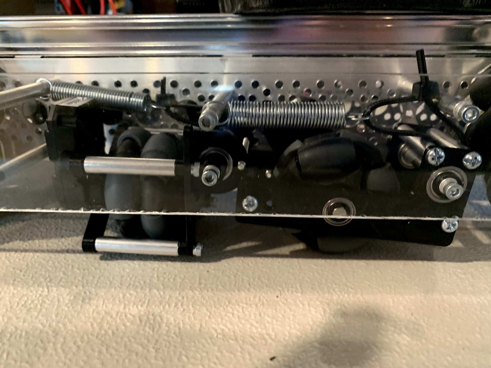

Q: Why is FTC so obsessed with deadwheel odometry? Top FRC teams don’t need to, why would they?
A: Well, to answer that we need to explain a few things.
Preface: What’s a deadwheel odometry?
When motion planned autos was first popularized by Gluten Free’s 3-year run of dominance in 2018, 2019, and 2020, they also popularized using these small unpowered omni-wheel pods, usually on a springed suspension, connected to quadrature encoders.
Three of them on a drivebase (or two with an IMU) is sufficient to calculate displacement on the x, y, and rotation axes, as each omni wheel will only spin when the robot is moving in the axis of measurement while remaining stationary when the robot is moving perpendicular to it.
Knowing your displacement is important for robot localization — that is, knowing where your robot is on the field.
And knowing where you are on the field fast is important when you’re moving fast in order to make sure you’re moving to the correct spot fast.
Using the quadrature interface is fast on current FTC control systems, and this sort of integrating localization benefits from higher update rates as to reduce overall drift, as error can and will still accumulates as the robot drives.
And while other localization methods do pop up now and then, none have really displaced the role that deadwheel odometry plays in FTC.
But wait, in FRC we just use drivetrain encoders for this! Why do FTC teams bother? Well, for starters…
Traction: (or rather, the lack thereof)
In FRC, you get carpet, and you also get nitrile tread that might as well be welded to it. Your wheels don’t really slip even when you gun your motors at full blast. Thus, you have generally don’t really deal with slip error.
Like, this is why top teams love nitrile so much over Colsons, even if they obliterate way faster than Colsons. Not slipping is great for making that 3-piece auto repeatable.
In FTC, you play on a foam tile field.
Your drive wheels are also limited in how grippy they can be, as if they are too grippy they fail the field destruction test and are not allowed to be used.
Foam also has inconsistent coefficients of friction (the center of the tile has more CoF than the seams), and this isn’t even getting into the various materials that can be under foam fields at different venues — most competitions are held in places like school gyms with hard floors, but occasionally you’ll have events in libraries or Championships that have carpet underneath the mats.
On top of this, practically everyone in FTC uses mecanum. And mecanum isn’t known for being the most tractile drivetrain.
To summarize “why mecanum” in one sentence: Mecanum is to FTC what swerve is to FRC, and swerve is to FTC what diffy swerve is to FRC (at least before the 4 motor limit).
We even have a similar dynamic to the issues in this thread where starter kits encourage teams to build 2 motor 2+2 tank drivetrains whereas everyone competitive uses mecanum instead. At least mecanum only needs about 10 lines of code and doesn’t need sensor feedback to drive.
Overall, this means that your drivebase will almost certainly slip if you gun it at full acceleration.
You can try to motion profile to avoid this but you’ll likely come out slower than gunning it.
Traction is the main reason why springloaded omni pods have consistently won over drivetrain encoders. They just straight up perform better because they compensate for limitations inherent to FTC.
