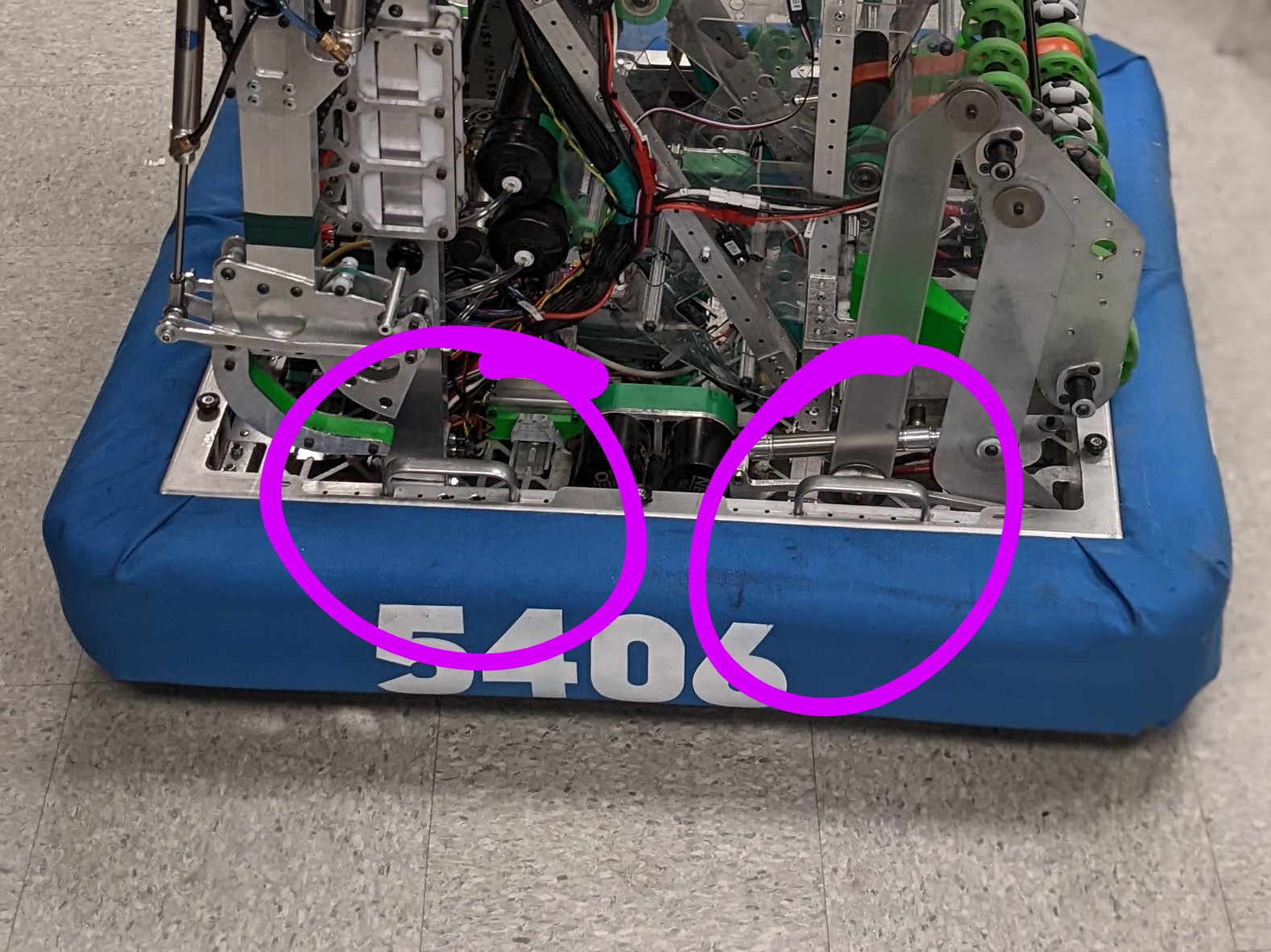

Putting aside carts on the field, we always require good handles on our robots for safety. I don’t think FIRST can have a similar mandate without a lot of complicated new rules, but maybe they can add a bit in the manual encouraging handles, and showing some example pictures?
