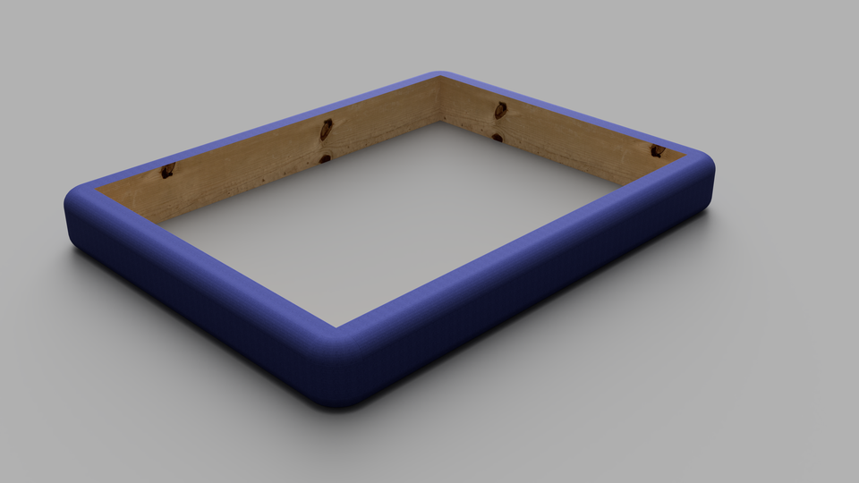

I was wondering how teams made “closed” bumpers without any openings in the middle. How would you attach the fabric without a visible seam? Something like the cad rendering I found.

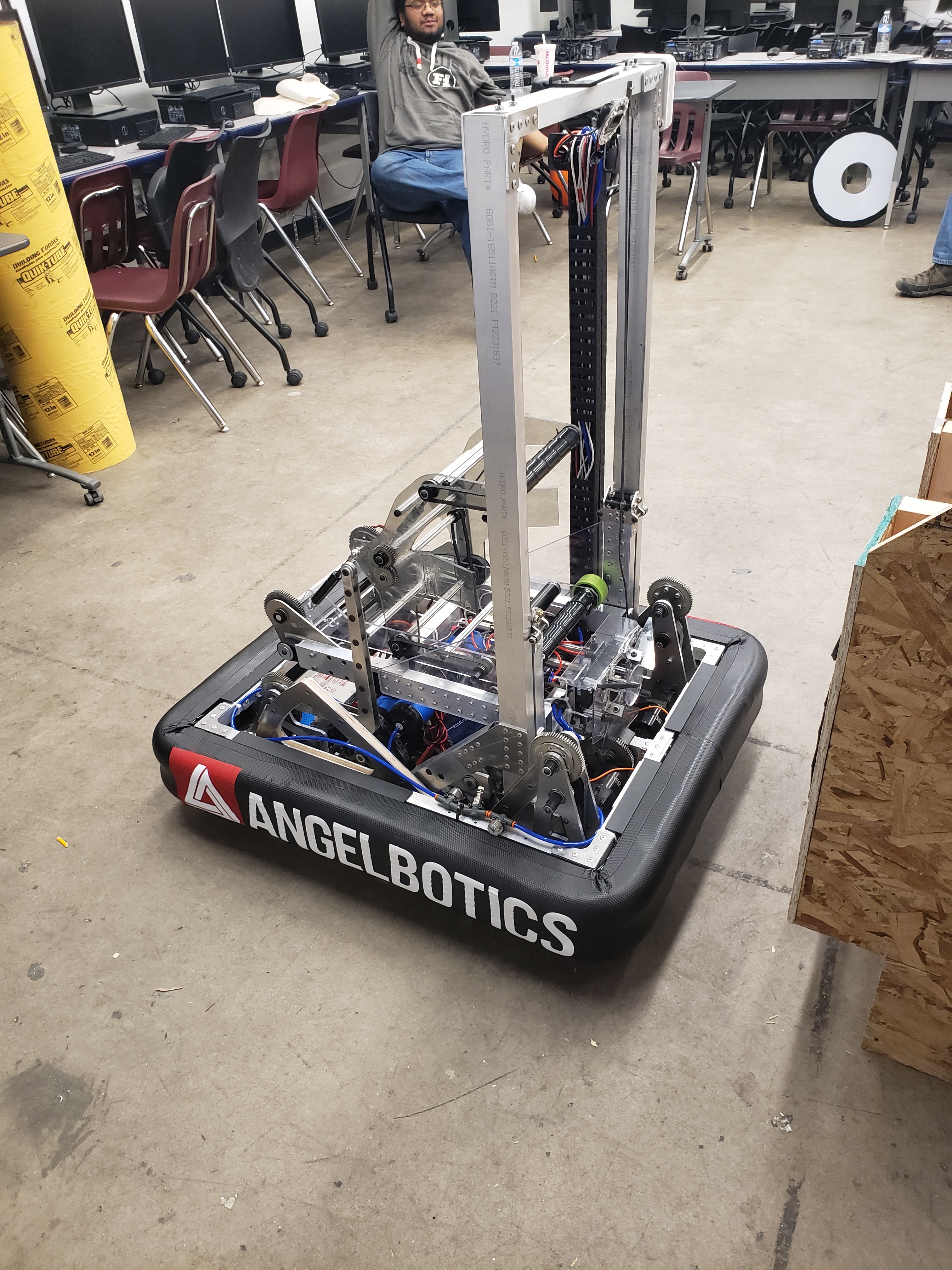

Specifically-- you sew a closed loop, making it loose at first, and then progressively take in the seam until the loop is tight around the noodles.
CAD models are great for making things in impossible ways (such as no seams)

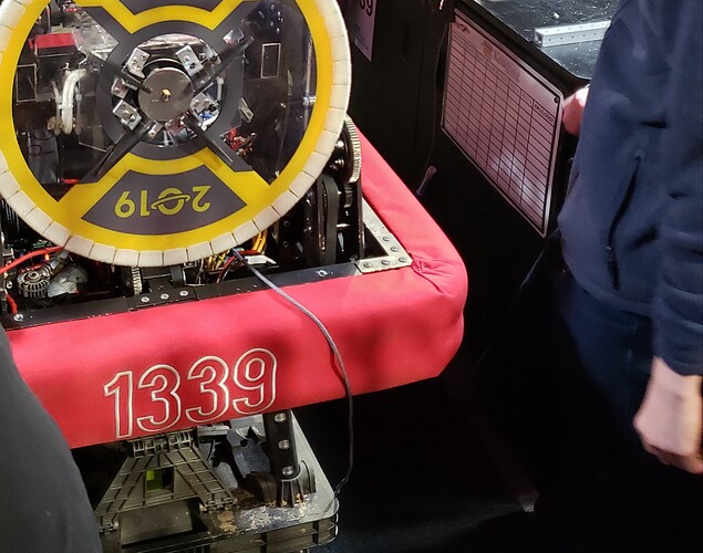

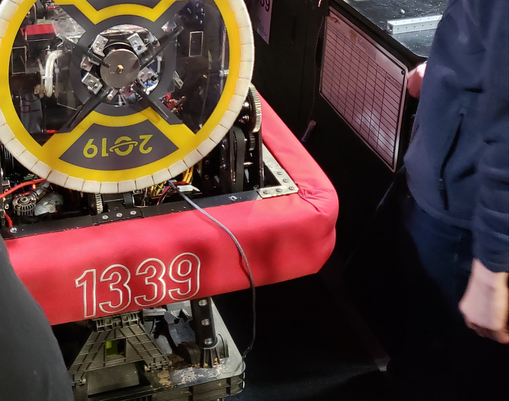

I washed and machine dried our bumper fabric after it was sewn up, thus shrinking it a bit (1000 denier Cordura) and tightening the fabric up some. The black bumpers above we made using cosplay fabric, which looks great stretched. I don’t think cosplay fabrics would be frc legal (depends on the inspector I suppose) but they are lots of fun to work with.
Strange that they cad a seamless loop of bumper (which is actually possible if it’s knitted btw), but model those big honking knots in the lumber. If you’re going to use lumber (rather than plywood), at least get smoother-grained wood!

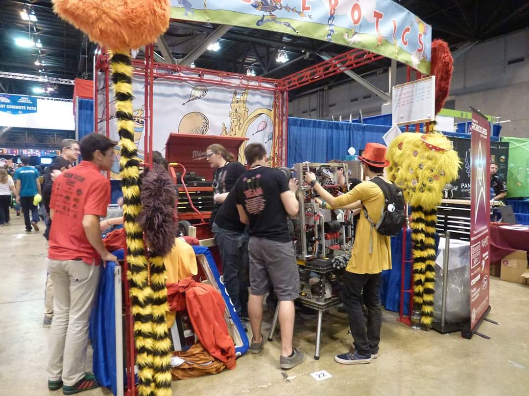

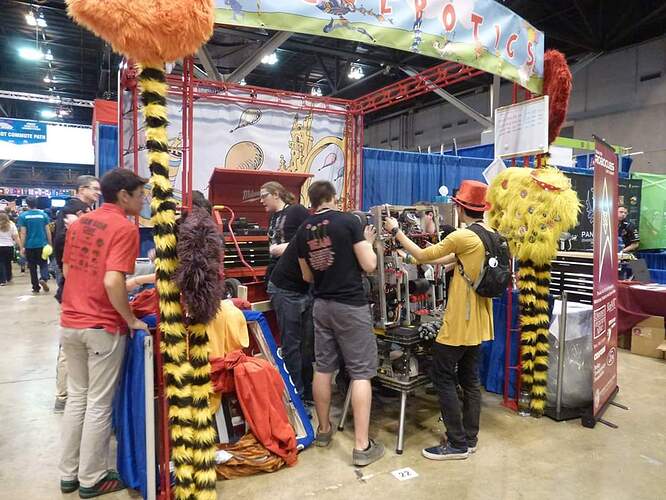

Somewhere I have a picture of our Thneed bumpers from 2016. We were Dr. Seuss themed that year and had Truffula Trees in our pit at Champs.
This isn’t the bumper picture, but here’s our pit.
You could use upholstery vinyl. Make it as tight as you can then use a heat gun to heat it up (you can heat it a lot more than you will think but be careful not to burn the vinyl or the noodles) It will shrink to fit as it cools down.
If you play with it enough, you might even be able to fit those round corners without any seam or pleat either. (That’s how I make a single piece just ski seat)
I would even think upholstery vinyl would be durable enough to pass inspection if you decided you wanted to use it. But have tape because it tends to be easy to slice.
