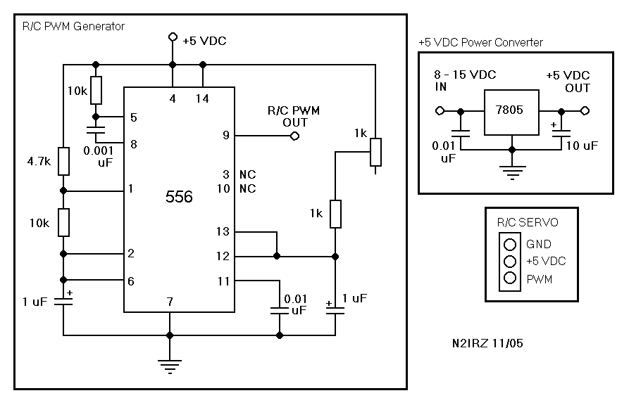

After all of the interesting discussion of 555s I’m not exactly sure if you are more interested in building a PWM controller from a 555 or if you are more interested in a PWM controller just to test your Victors.
If it is the latter and you just want to buy something off the shelf, may I suggest the FMA Direct Servo Lab. You can get it from Tower Hobbies (http://www2.towerhobbies.com/cgi-bin/wti0001p?&I=LXJVD9&P=0) or other hobby places for less than $35. It is really useful for testing Victors and test driving motors connected to a Victor (and power) without having to have the whole IFI control system hooked up. It also will “read” the PWM signal from the IFI Robot Controller which can be very useful to see how the joystick and code are responding. You can even hook it up in line between the RC and the Victor. Works great, I highly recommend one. If you get one you will need to get a cheap RC battery as well if you don’t have one.
Another COTS option that is a little less expensive (~$20) is the Astro Flight Servo Tester (http://www2.towerhobbies.com/cgi-bin/wti0001p?&I=LXVK79&P=0). I don’t personally have one of these but it should do what you want (manually control the Victor) but it will not “read” the PWM signal from the RC like the FMA Direct Servo Lab.
Now everyone can get back to discussing the pros and cons of a 555…

That is correct for an R/C servo, but incorrect for a Victor or similar PWM motor control.
For a PWM motor control, the duty cycle of the signal varies from 0% to 100%, corresponding to full reverse and full forward, respectively, with 50% being neutral.
[EDIT:] I stand corrected, the Victor uses standard R/C type PWM control, which operates as described in the quote above. The circuit I have won’t work here, but there was a circuit in SERVO (or maybe Nuts & Volts?) earlier this year that had such a circuit using a 556. When I find that I will post a reference to it. [/EDIT:]
I have a circuit somewhere that does exactly what he wants, uses a single 555 and a few passive components, and varies from about 3% ro 97% duty cycle. I’ll post it when I find it.

As promised, here is the circuit that produces variable width pulses (1 to 2 uSec) at about 60 Hz. This is fairly simple to build, components are not very critical, Radio Shack sells all of the parts. All of the resistors are 1/4 watt 10% or 5% tolerance, the capacitors 1 uF and above are electrolytic or tantalum, the small caps are ceramic monolithic (ar whatever is on hand).
I have included a way of converting some higher voltage (e.g. 12 volts) down to 5 volts using a 7805 regulator, along with the pinout of the Victor PWM signal inputs. Remember, black is ground and white (or yellow) is the PWM signal.
This will drive a Victor or any R/C servo from nearly full reverse to full forward, depending on the setting of the 1 k Ohm potentiometer. Note that there are some PWM motor controllers that do NOT use R/C type PWM inputs; this will not work with those.
Have fun
Don
